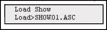

Load show from card
This is done from the Save/Load Show menu
Menu>Save/Load Show>[Load show]
Select the show with the wheel. Confirm loading by pressing MENU.The default show offered for loading will be the last show, or the lowest numbered recording on the card.

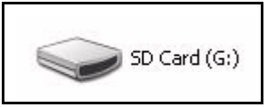

Step 1: Insert the SD card into its reading device. Make sure the device is connected to your Windows PC.
Step 2: The SD card will appear as a new drive. You should be able to find it as an icon with some drive letter A-Z under My Computer.

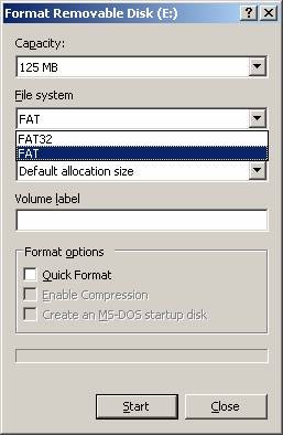

Step 3: Right-click on the SD card icon and select Format. This will open the formatting window.
Step 4: In the File System field, select FAT. This will establish the card’s file system as FAT16.
Step 5: Click Start and then complete the formatting process.
