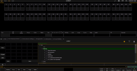

  2. Navigate to the [Save as] option
  3. Select your USB stick from the list of available drives

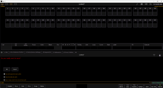

  4. Double click your USB drive with your mouse, this will open a prompt asking " Do you really want to save". NOTE: You will also be asked what type of showfile you will want to save it as. Refer to the Eos Augment3d Show File Types article for more information.

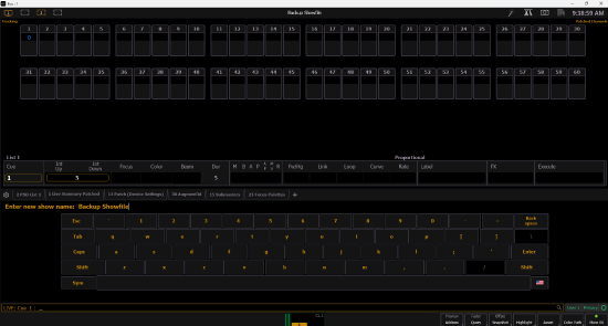

  5. After choosing your file type, select [OK]. You will receive another prompt asking you to name your Eos showfile. Warning: make sure you are actually creating a saved file and not a folder within your USB.
  6. After naming your showfile, you have successfully saved your showfile to your USB drive! You can confirm if the showfile has been properly saved by looking at the showfile name at the top-center of the monitor. If the name has an asterisk (*) next to it then it has not been saved.
