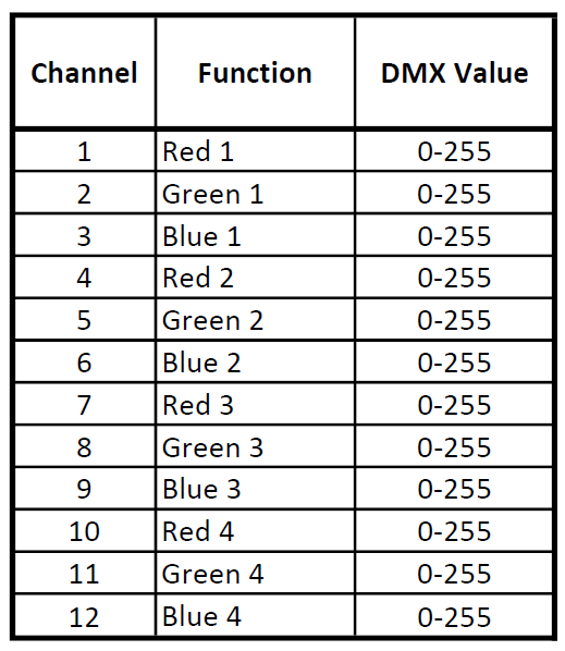

An example of a compound fixture might be a 4 cell RGB bar. From a DMX perspective, the 4 cell RGB bar is actually just 4 RGB LEDs.
Example DMX chart below:
