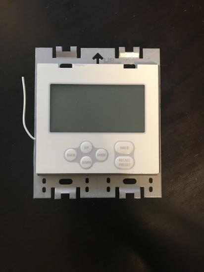

Since the Echoflex Wireless TimeClock includes a metal plate near the internal antenna and metal inhibits wireless communication, what is the best way to orient the antenna for signal strength?
Answer
Shape the internal whip antenna into a “J” or hockey stick with the tip pointing up an away from the metal mounting bracket. Ensure the tip of the antenna is not touching any metal.
