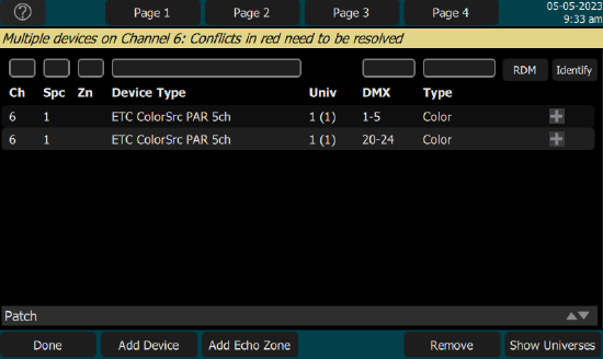

Symptoms/Issue
When attempting to patch multiple multi-parameter fixtures to the same channel in EchoTouch it gives an error of "Multiple devices on channel 'x': conflicts in red need to be resolved", but shows nothing in red.
Description/Explanation of Issue
This issue is present in v3.2.1 and only shows up after exiting and re-entering patch
Fix/Solution
Despite the error message, the EchoTouch will still output correctly. There's no actual conflict to resolve here, and the error can be ignored.
