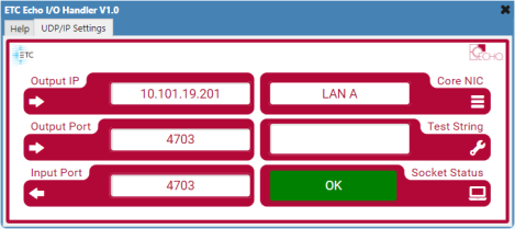

I/O Handler Setup
Runtime Elements UDP/IP
  • Output IP
    • IP address of the Echo Integration Interface (EII) or EchoTouch (ET)
  • Output Port
    • Echo UDP port to send commands to
  • Input Port
    • Q-SYS UDP to receive status updates on
  • Core NIC
    • Select the core NIC that is connected to the Echo control system
    • Not Selected (default)
  • Test String
    • Send/receive to/from Echo to verify bidirectional communication is occurring
    • Send E$help to Echo to verify bidirectional communication
      • Echo will send a reply with all commands within the API
  • Socket Status (read only)
    • Indicates OK when the proper IP, UDP ports and NIC  have been properly entered/selected and the core's hardware is operating properly
    • Indicates when in emulation mode
    • Indicates when a fault has occurred
