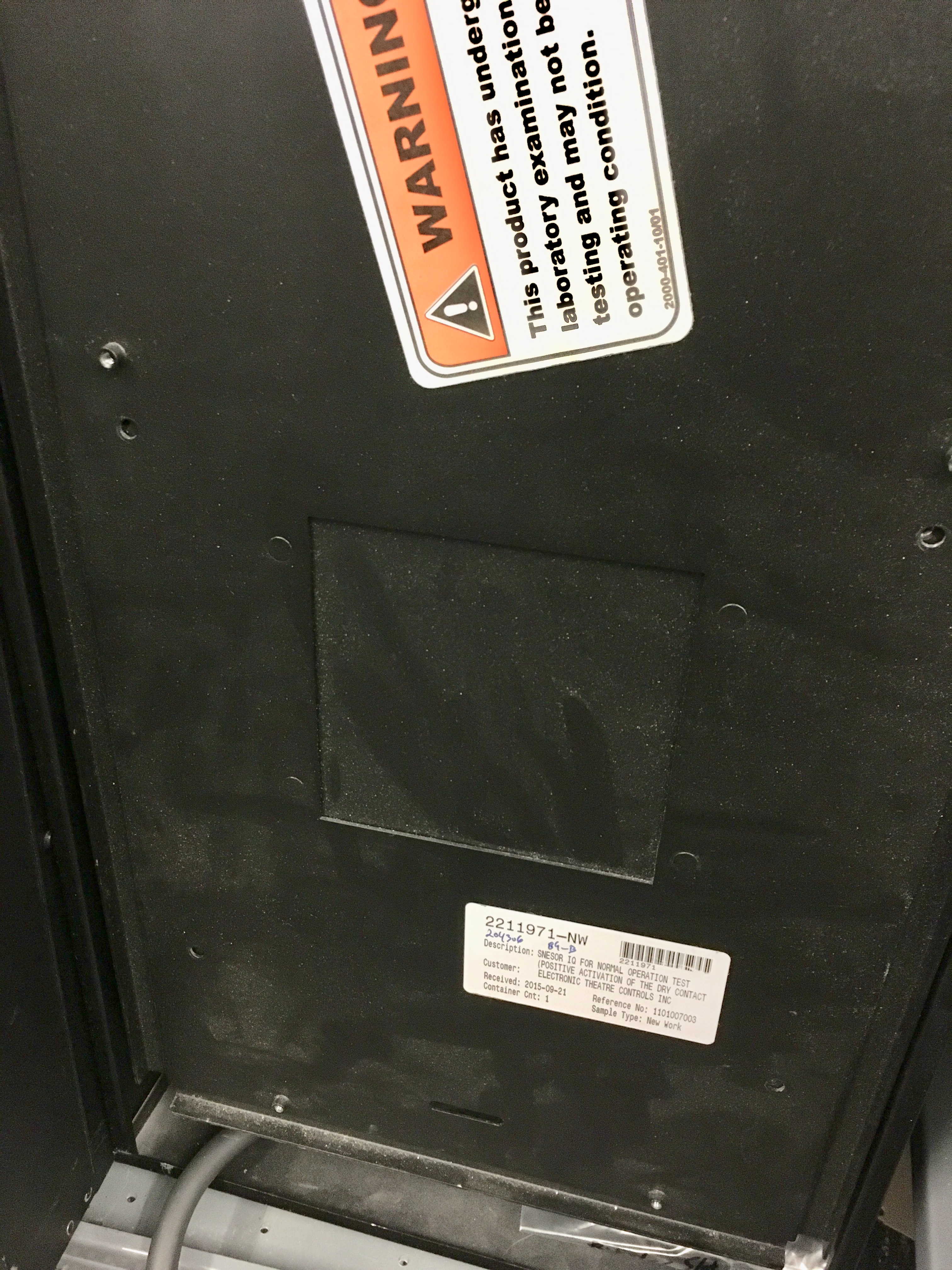

If the subpanel for the rack is installed backwards, especially if it is an SIQ 48, the threaded studs for the Main Breaker cover will be on the wrong side and can get in the way of the door.
Example of incorrect installation:
Fix/Solution
  1. Unscrew and remove the panel door
  2. Unscrew the subpanel at all points
  3. Flip the panel around so the threaded studs are hidden
  4. Re-secure the subpanel
  5. Your final product should look like the following:
