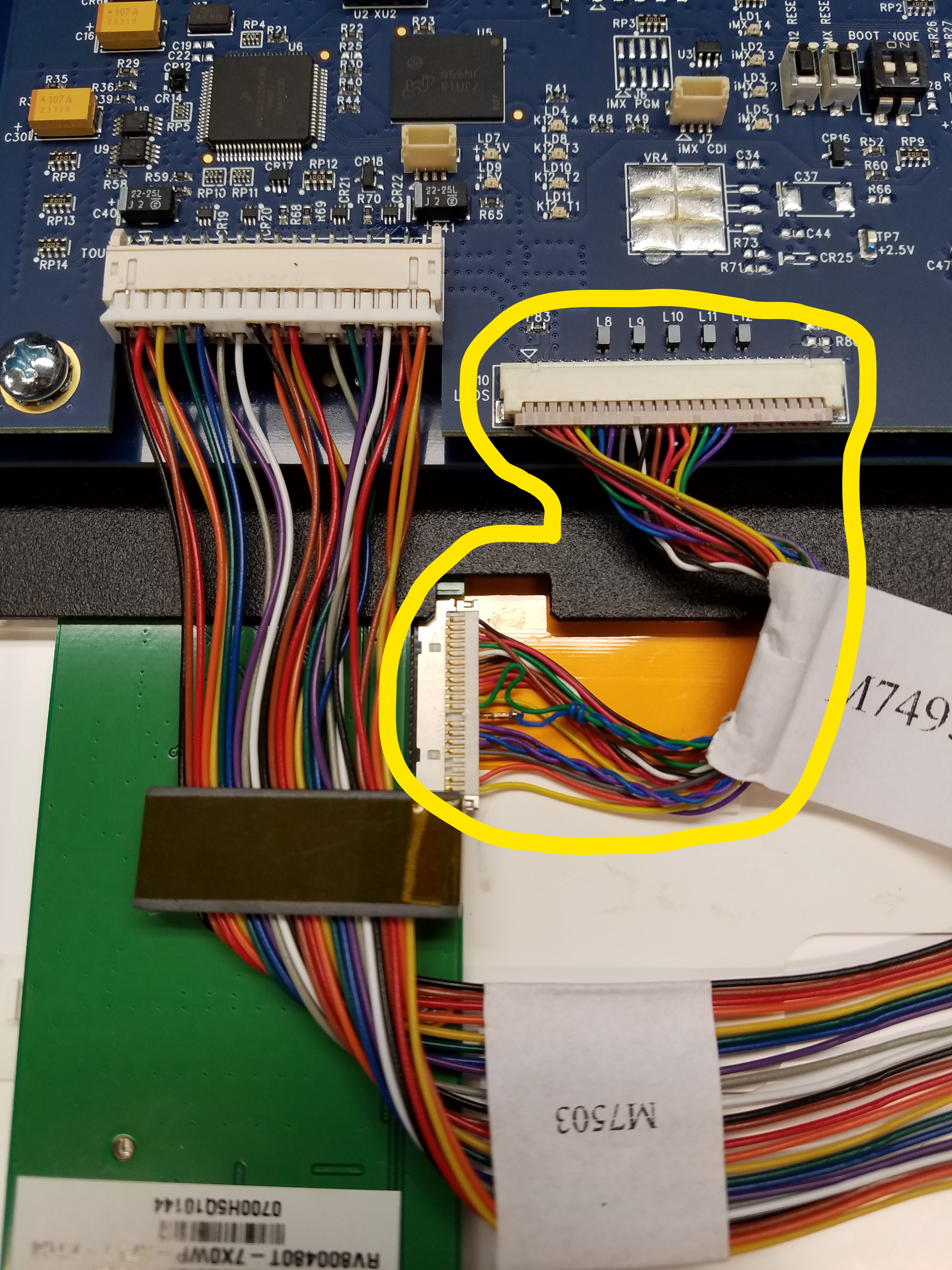

If a ColorSource console is booting (bump button LEDs scroll from right to left) but has an unreadable LCD, the LVDS cable is either partially unplugged or bad
Fix/Solution
  • If you are comfortable with attempting the repair yourself, open the console by flipping it over and unscrewing the two bottom plates
  • Inspect the cable for wires that are not properly seated in the cable connector
  • Reattach the two bottom plates of the console
