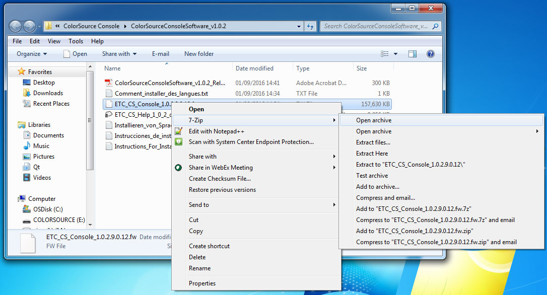

  2. Extract the contents of the ZIP somewhere on your PC:
  3. Right-click on the “ETC_CS_Console_X.X.X.X.X.X.fw” file and choose “7-Zip” > “Open Archive”:

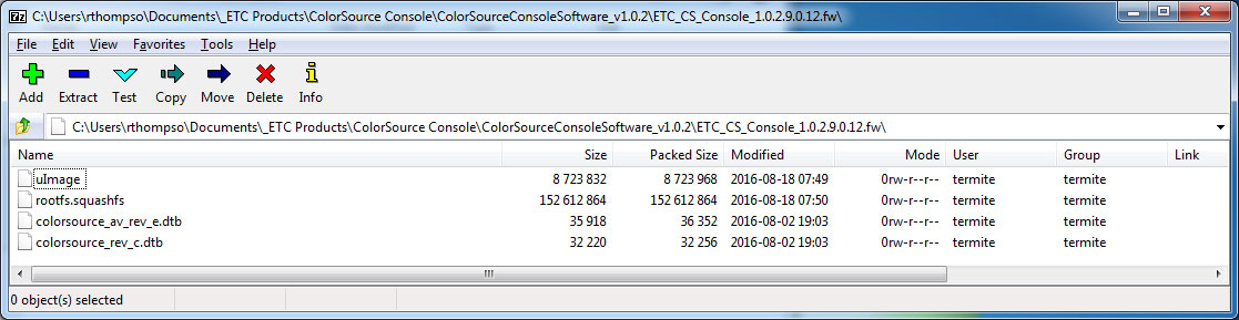

  4. 7-Zip will open and show a list of files.
    Boot Stick Recovery
  5. Drag and drop all of these files onto the root of your USB stick.
