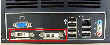

The easiest way to determine if your Element has a WinXP or Win7 motherboard is by looking at the back of the console. The WinXP units only have 1 network port, while the Win7 units have 2.  WinXP has a VGA monitor port.  Win7 has a DisplayPort monitor port.
Rear Panel Images
Windows XP
Windows 7
