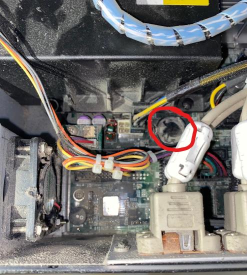

When replacing the BIOS battery in an Eos Classic, it is necessary to remove the back lid of the console.
The BIOS battery is located on the motherboard and is populated on the board between the fan and the console's back USB porst.
