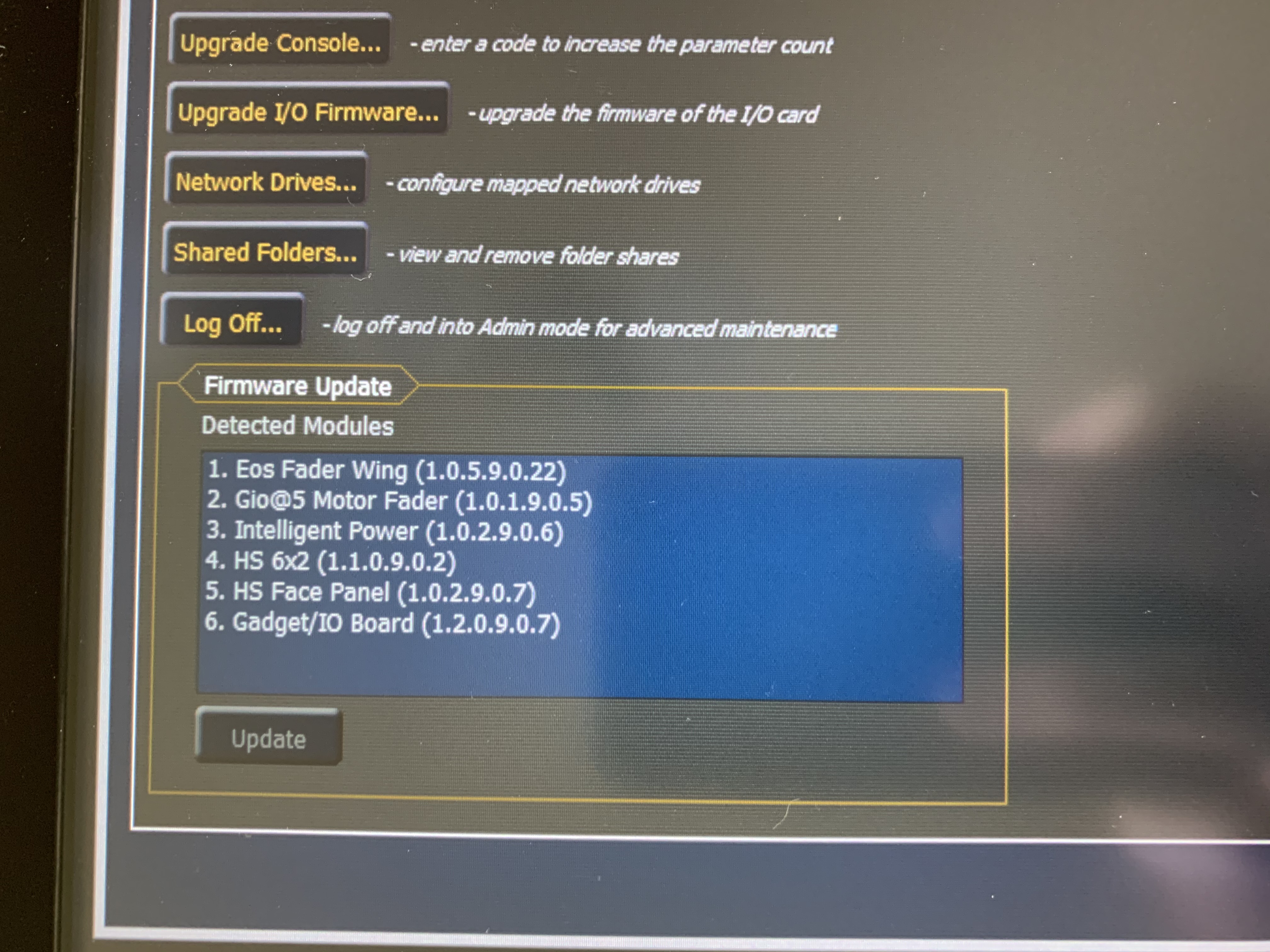

  • Exit Eos software to Eos "Shell" Setup (ECU) and navigate to "Maintenance"
  • Scroll all the way down to the box labeled "Firmware Update". If everything is working correctly, it should look like this (firmware version numbers might change). Look for "HS 6x2":
  • If any lign says "BOOTLOADER" , the respective module needs it's firmware re-installed again. Please get in touch with ETC Technical Support or any ETC Service provider.
  • If "HS 6x2" is not shown at all, there might be a physical connection problem requiring repair by a Service technician. Please get in touch with ETC Technical Support or any ETC Service provider.
