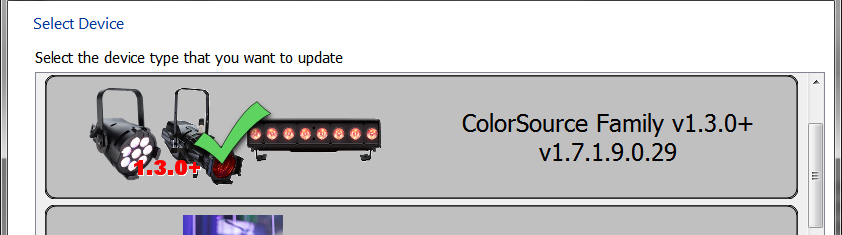

  1. If connected to a fixture via a USB/DMX Cable (USB Whip) or Gadget, click on USB/DMX Devices.USBDMX Devices.png
  2. Click Next and then select the ColorSource Family v1.3.0+ then click Next and finally Update Device(s).

  1. If connected via a Net3 Gateway, click on RDM Devices.
