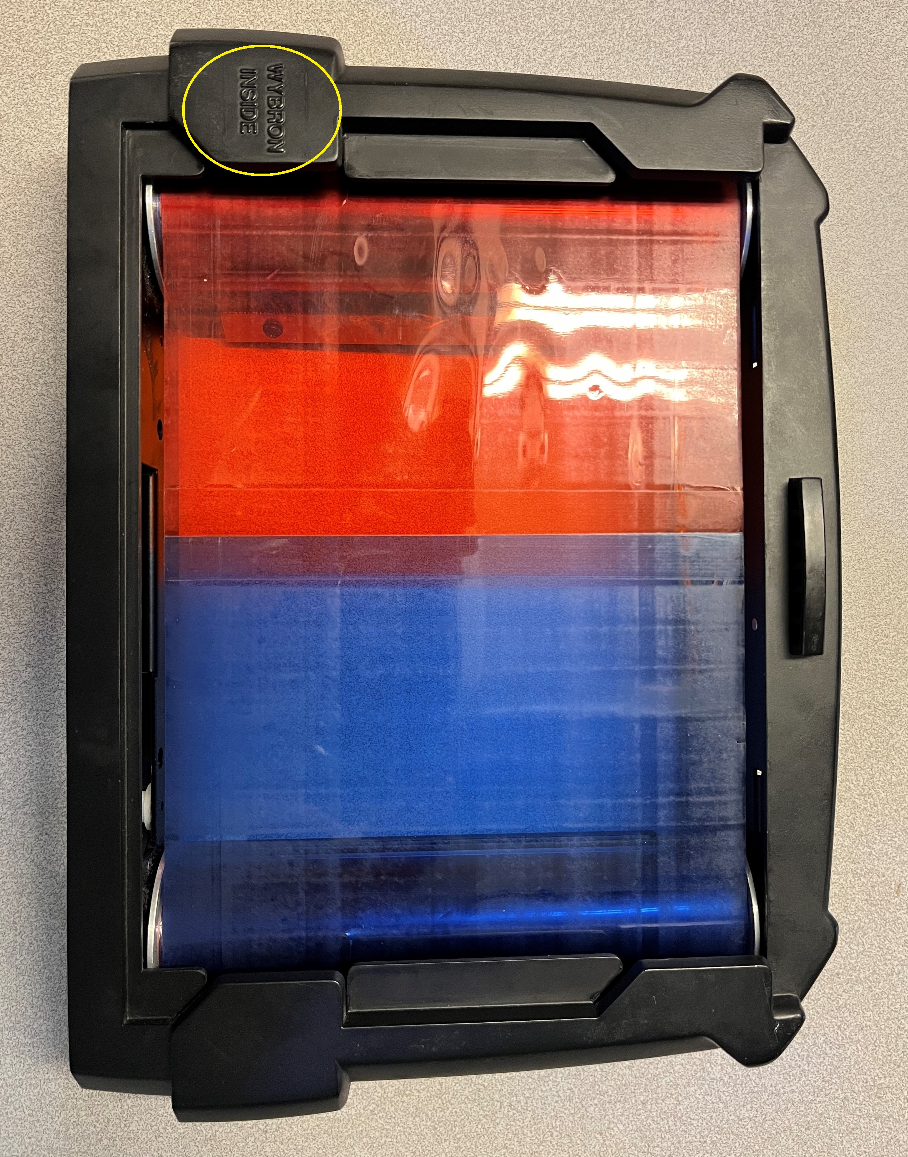

    2. Wybron color scroller:
      1. also note that the Wybron scroller is labeled "Wybron" on the outside.
