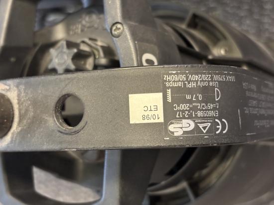

We mark the yokes of all fixtures sold with a sticker denoting the month and year in which the fixture was produced:
  • The fixture in this image is from October of 1998.
