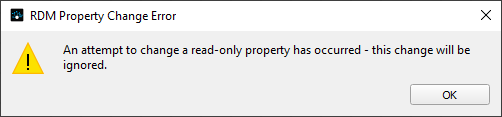

If you are using Net3 Concert to record a Preset, you may see this error:
["An attempt to change a read-only property has occurred - this change will be ignored"]
