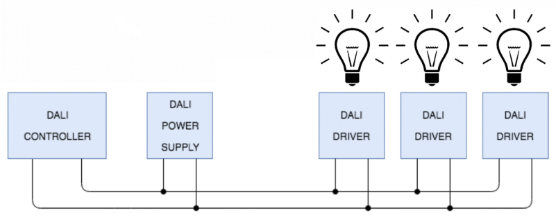

A DALI Loop has a single DALI controller, a DALI Bus Power Supply, and DALI drivers. A DALI loop supports up to 64 drivers. When more than 64 devices are needed, add additional loops to the installation.

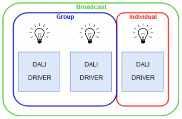

  • Control commands are summarized into three categories: Broadcast, Group, and Individual.
  • Broadcast commands affect all drivers in a loop. Such as sending all of them to a level.
  • Group commands affect only drivers that are a member of that group. Group membership is stored at the driver but configured using the DALI controller.
  • A driver can belong to any combination of groups with a maximum of 16 groups available.
  • Individual commands affect a specific driver using its short address.

The infrastructure of a DALI system is similar to station wiring for a Paradigm system. Like Paradigm, DALI is topology-free and polarity-free. Two conductors are installed between components of the loop referred to as the “DALI Bus”.  You can connect multiple drivers to the same wiring bus allowing multiple fixtures to be controlled by a pair of conductors.   Unlike Paradigm, DALI bus wiring is also permitted to be installed in the same conduit as line voltage conductors (Class 1).
The length limitation per loop is 300 meters.
The power limitation per loop is 250mA.
A DALI Bus Power Supply is required for each DALI loop.  This power supply should not be confused with off-the-shelf DC power supplies. It needs to specifically be a DALI bus power supply.    A typical DALI power supply outputs approximately 16 VDC.  When a DALI loop is energized, metering the loop shows a fluctuating voltage that is usually +/- 2-3 VDC from the power supply output rating.  This fluctuation is how messages are sent between devices in a DALI loop.  No fluctuation in voltage or no voltage is usually an indication of a communication or a wiring problem somewhere in the bus.
