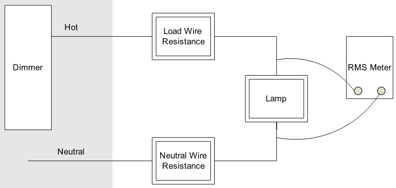

Load circuit length and size on both the hot and neutral create another source of resistance resulting in additional voltage drop. These factors will change the RMS voltage at the fixture.   Refer to the figure below which shows a basic voltage divider circuit built with three resistors; hot wire, load, and neutral wire. With 200’ of 12-gauge wire and a 750W lamp on the circuit, the voltage drop on each of the hot and neutral wires is about 2V.  Therefore, your measured RMS voltage across the lamp is now 4V less than what the dimmer is set to deliver. A large load will create a greater voltage drop in the circuit since the voltage drop across each conductor is based on the current the lamp draws and the resistance in the wire.
