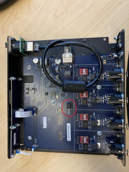

  1. With a #1 Phillips Screwdriver, remove the 8 screws pictured below and slide out the top chassis.
  2. Carefully remove the spare chip and put in place of the chip in the port that is not working (labeled on the circuit board at "DMX 1" through "DMX 2".
