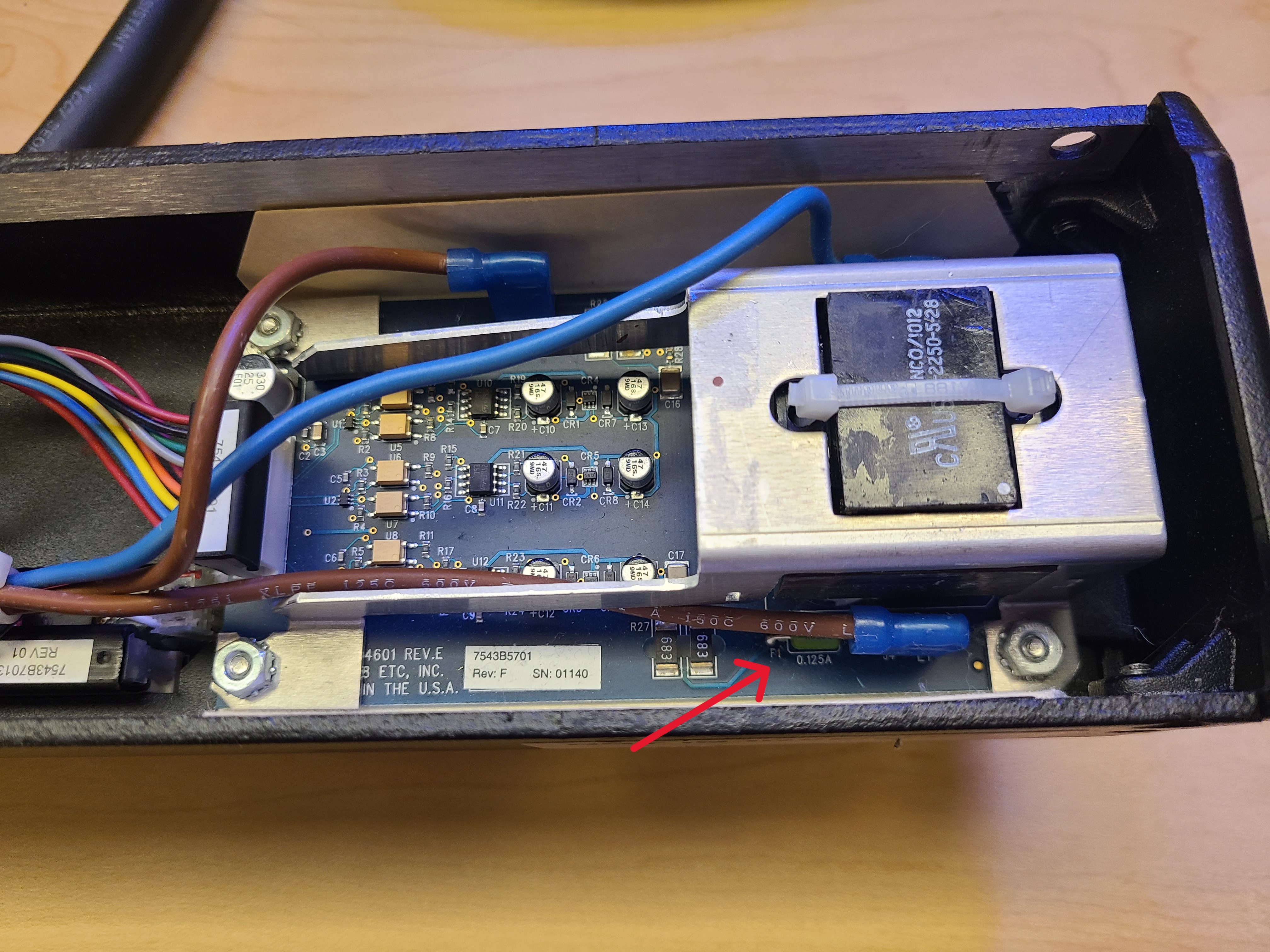

  2. With the back cover removed, locate F1 on the power supply board, located behind the UI:
  3. Set a digital multimeter for Ohms (Ω) and place the lead the connection points on opposite sides of F1.
  4. If the meter reads 0Ω, the fuse is good. If it reads OL, this means the fuse is bad and should be replaced.
  5. The fuse must be replaced by removing the board soldering in a new one. The ETC part number for this fuse is F391-F; it is a 0.5A 250v PCB fuse. This can be ordered from any ETC dealer. If you are not comfortable performing this repair, you can use the same link to look for an Authorized Service Provider to do it for you.
