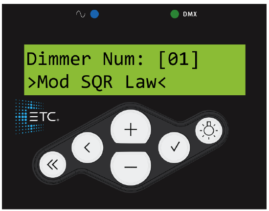

  1. Press the [+] or [-] button until you have "Dimmer Curves". Then press  [√].
  2. The brackets will appear around the circuit number. Press [+] or [-] to change the number and then press [√] to adjust that circuits' curve
  3. The brackets will appear around the dimmer curve setting for the selected circuit. Press [+] or [-] to change dimming behavior and then press [√] to apply that selection
