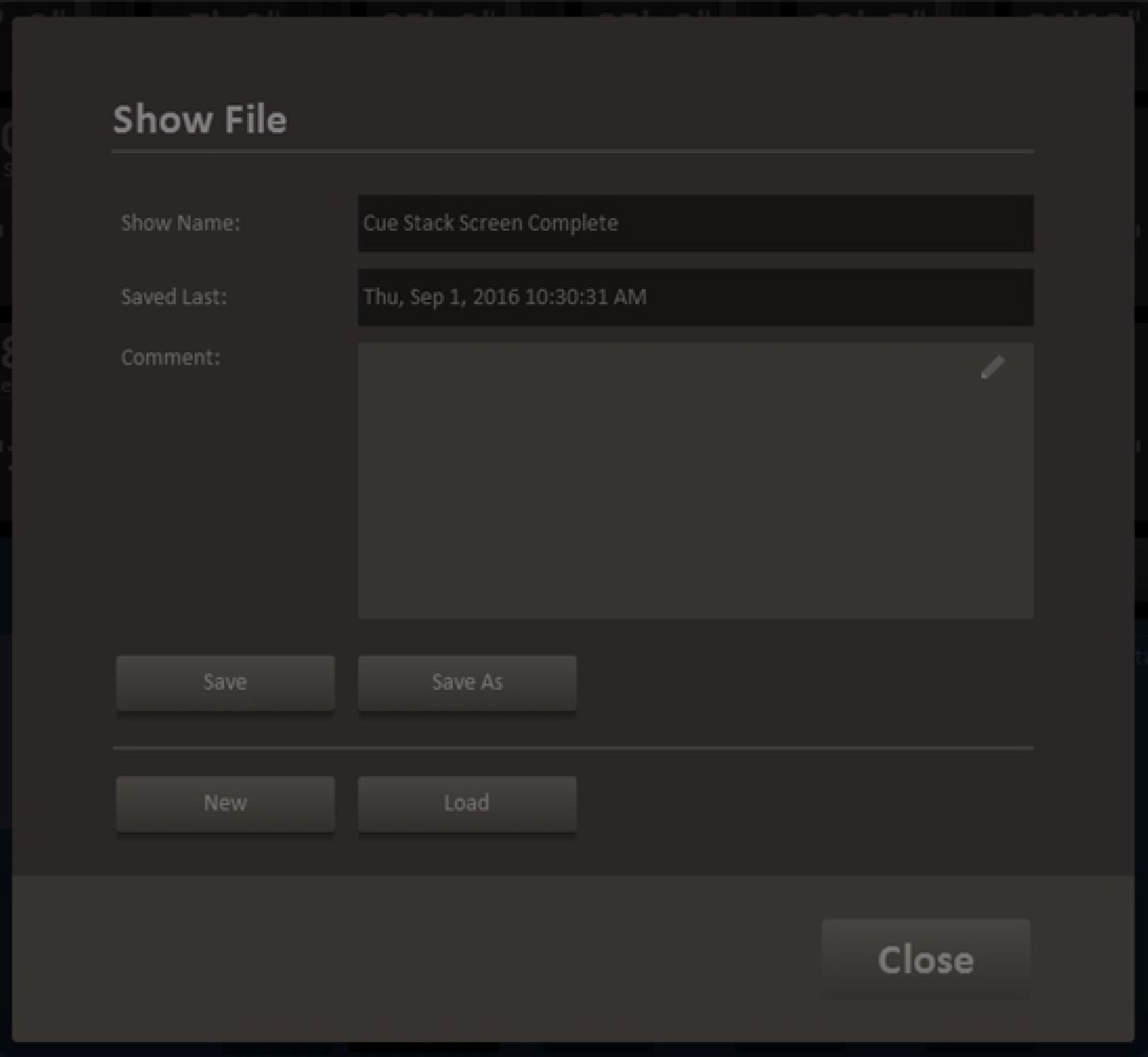

To access the show file dialog:
  1. Press the menu button in the lower left corner. The menu options will appear.
  2. Select "File." The "Show File" dialog will appear.
