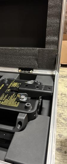

Lid on the road case will not close with mounting hardware attached to the fixtures.
Explanation of Issue
The road case for Lonestar, part number 2550K1001 needs the foam modified depending on the orientation and type of brackets + clamps used.
New truss mount cantilever bracket part number 2599A2000
Part number for the old truss mount bracket 2550A3005
Solution
  1. Attach clamp to bracket
  2. Fasten combined hardware to the designated 1/4 turn mounting points on the fixture
  3. Test closing the case lid
  4. Remove portions of foam where the lid and hardware collide
  5. Repeat steps 3 + 4 until the lid closes properly
