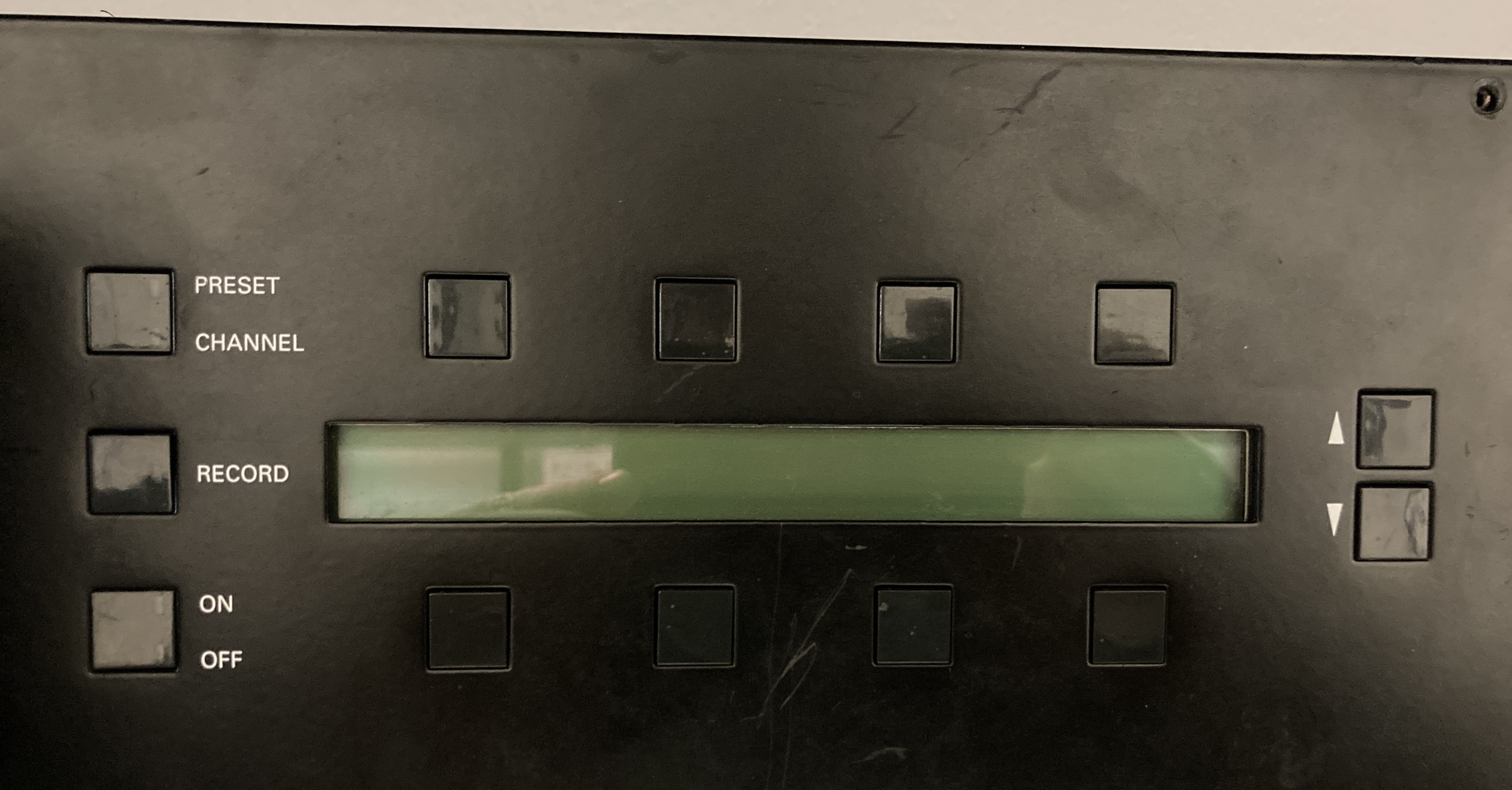

DAS LCD
Some DAS systems would have an LCD included which allows a direct interface into the configuration.
Making changes
If your system has button stations with record options and/or an LCD, you are able to make preset changes. If you have a DAS system with an LCD, you are able to make system changes such as control scope and patch. .
