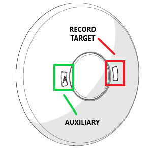

  • Auxiliary: this button is located on the face of the sensor with the letter 'A' on it, and is used alongside the Mode button to record presets.
  • Record Target: this button is located on the face of the sensor, and is used to record current lux levels as the target levels.
