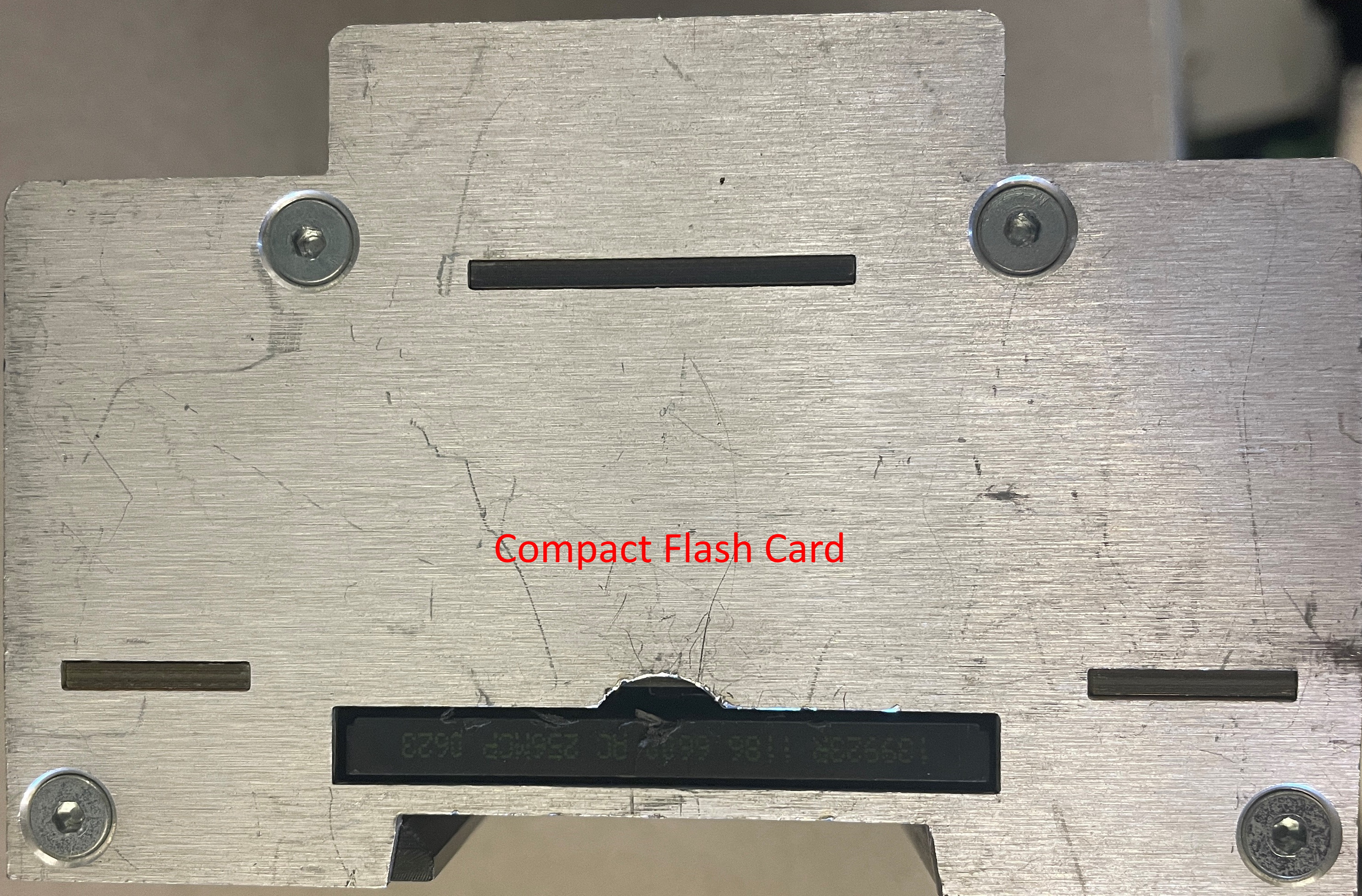

Any controller with a CF card, with the exception of the first generation MSC X, cannot be upgraded to version 2.0.

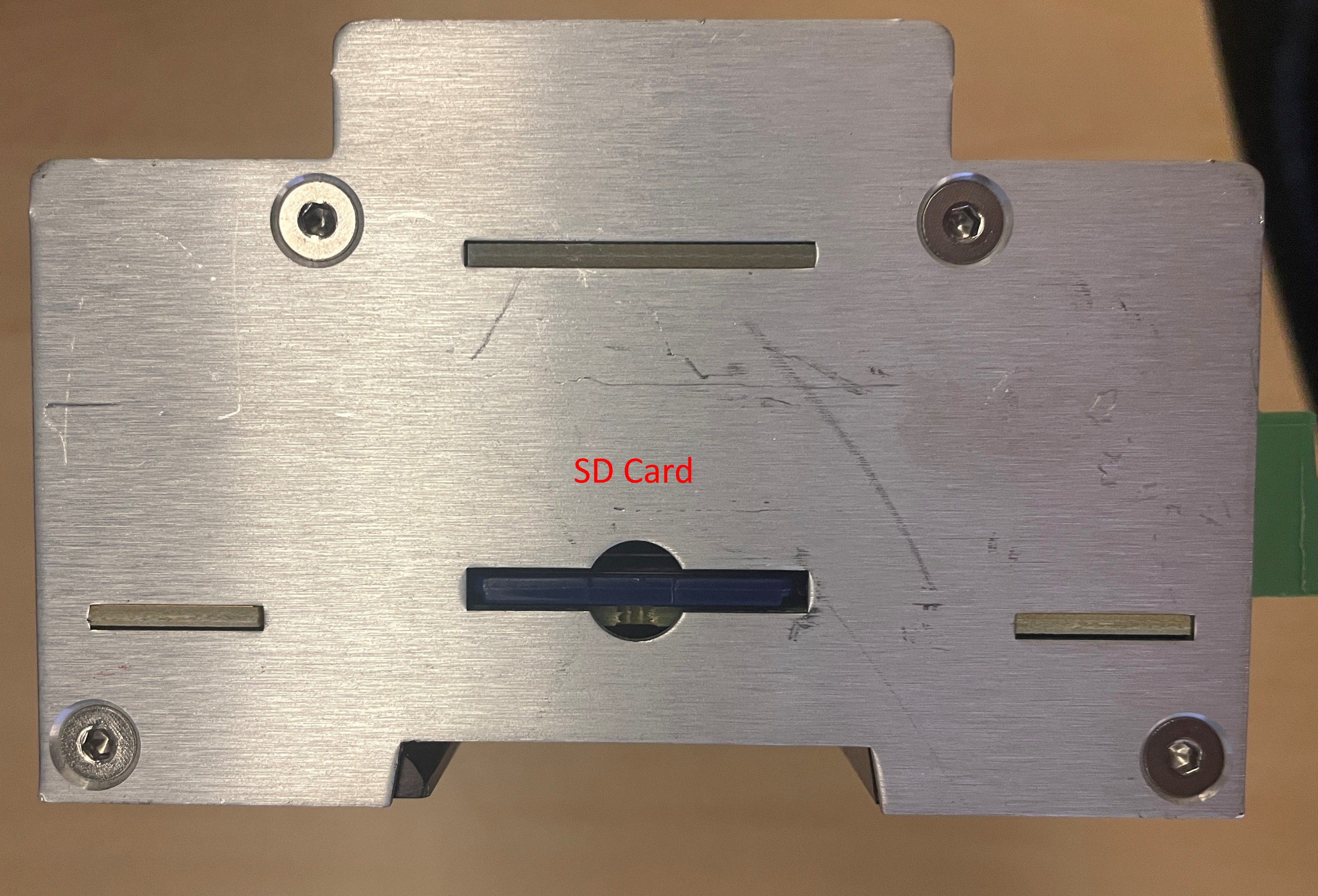

To determine which generation of controller you have remove the controller from the din-rail mount and check the left hand side of the controller.
Controllers with an SD will look this
Controllers with a CF card will look like this, these controller cannot be updated to version 2.0.
