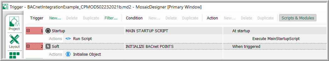

Initialize all BACnet points on Startup that you want exposed to the BACnet system:
