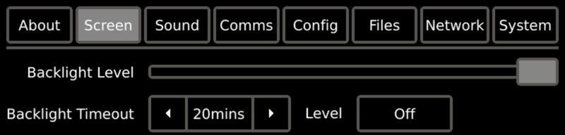

P-TS7
The P-TS7's Backlight Tiemout can be adjusted from its Setup menu on the Screen tab and is adjustable in 1-minute increments for a maximum of 60 minutes. The adjacent 'Level' setting determines if the display turns Off for goes to a Dim state when the display times out.
