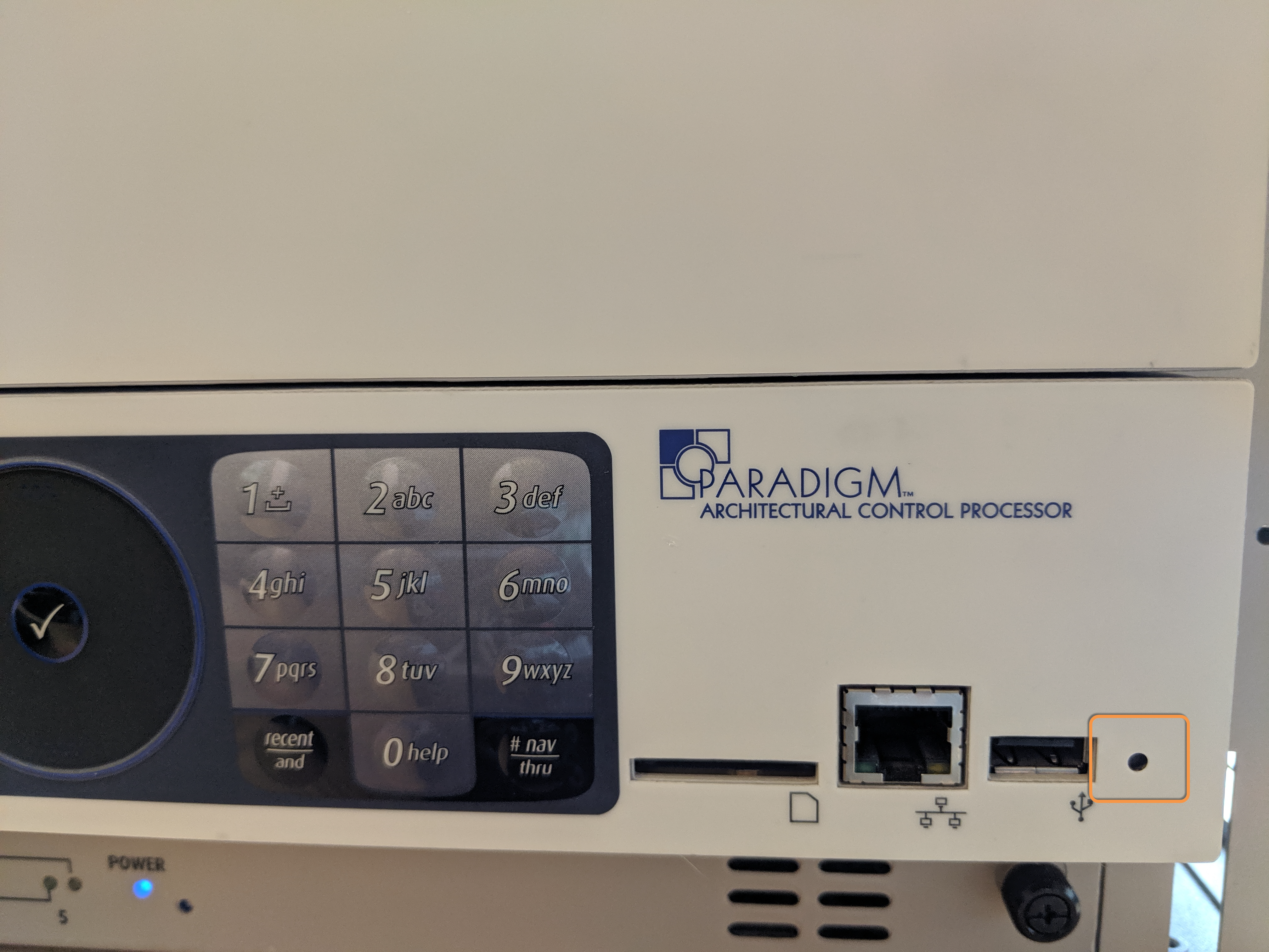

  1. Press the reset button on the Paradigm Architectural Control Processor (P-ACP).  This is a small hole next to the USB port on the processor.  Simply use a paperclip or pen tip to tap and release this button.
