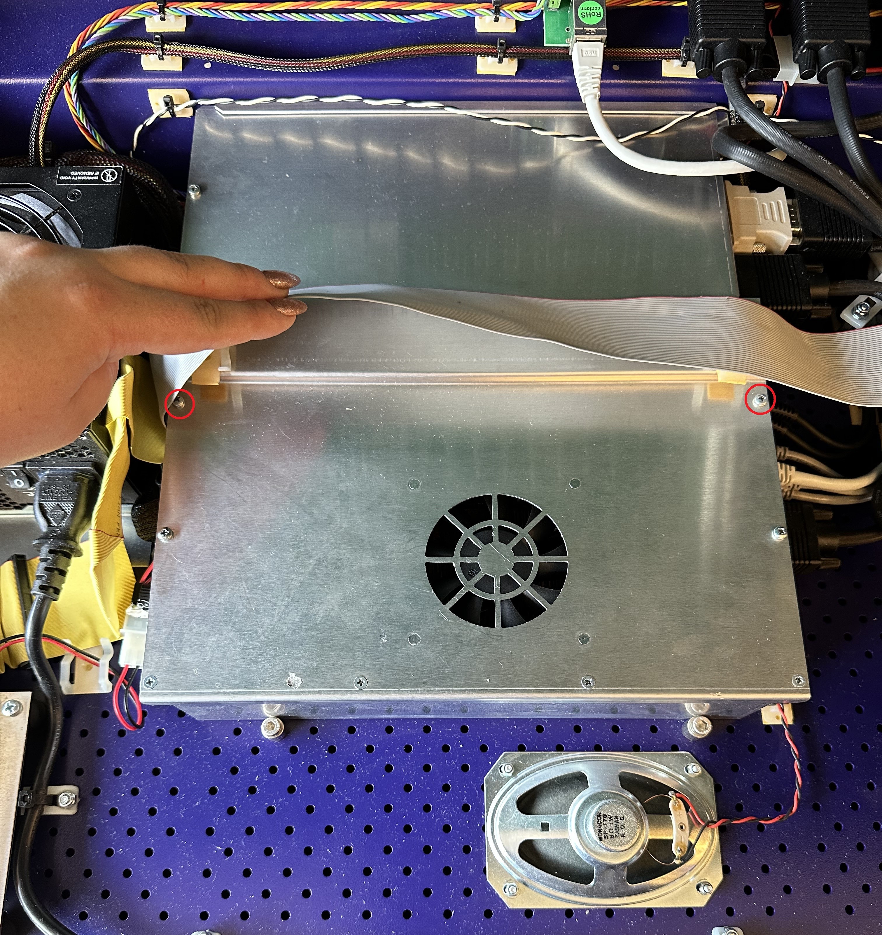

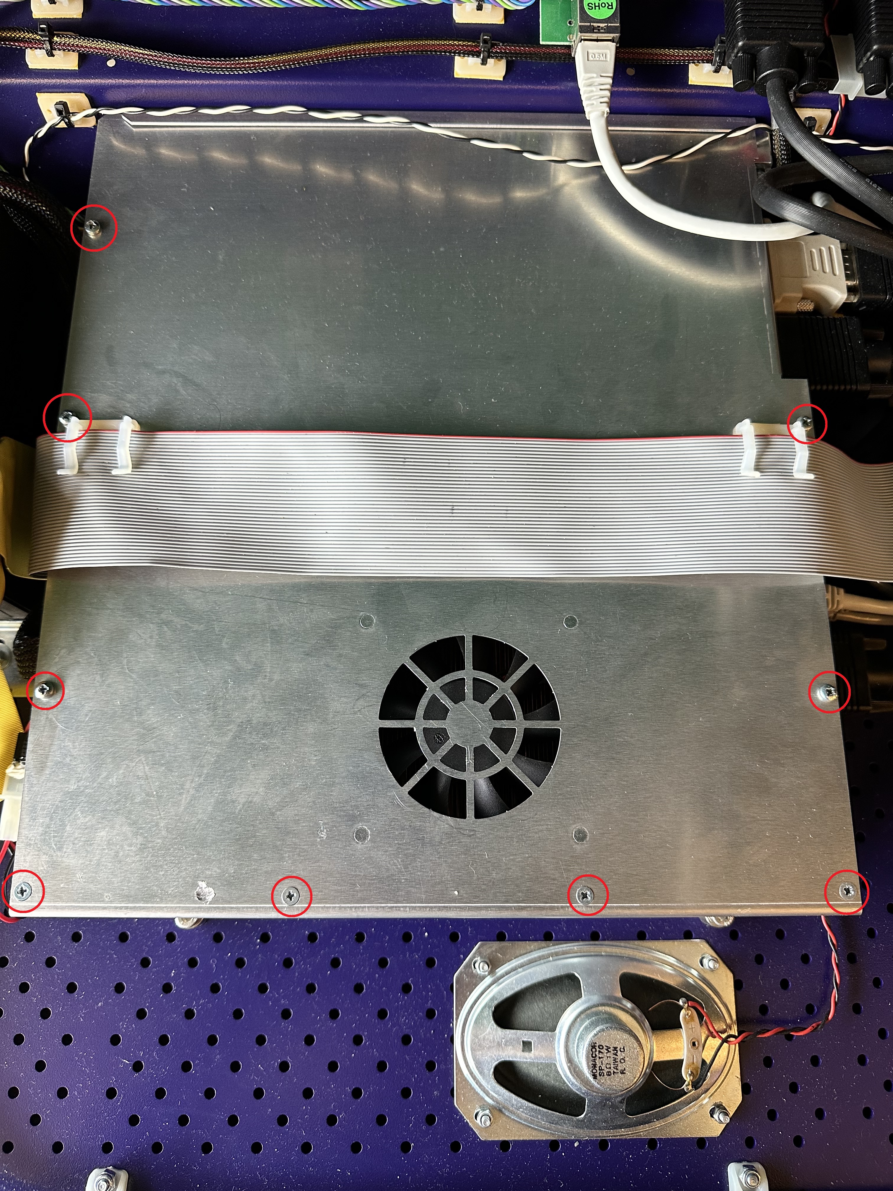

  1. Unhook the ribbon cable from the white hooks.
  2. Unscrew all screws on the silver top as shown below. Don't forget the two under the ribbon cable!
  3. Carefully pull the silver plate towards you and up. Be careful to not rip the fan harness. You may keep the fan plugged in or disconnect it, just ensure that you reconnect it before you close the console.

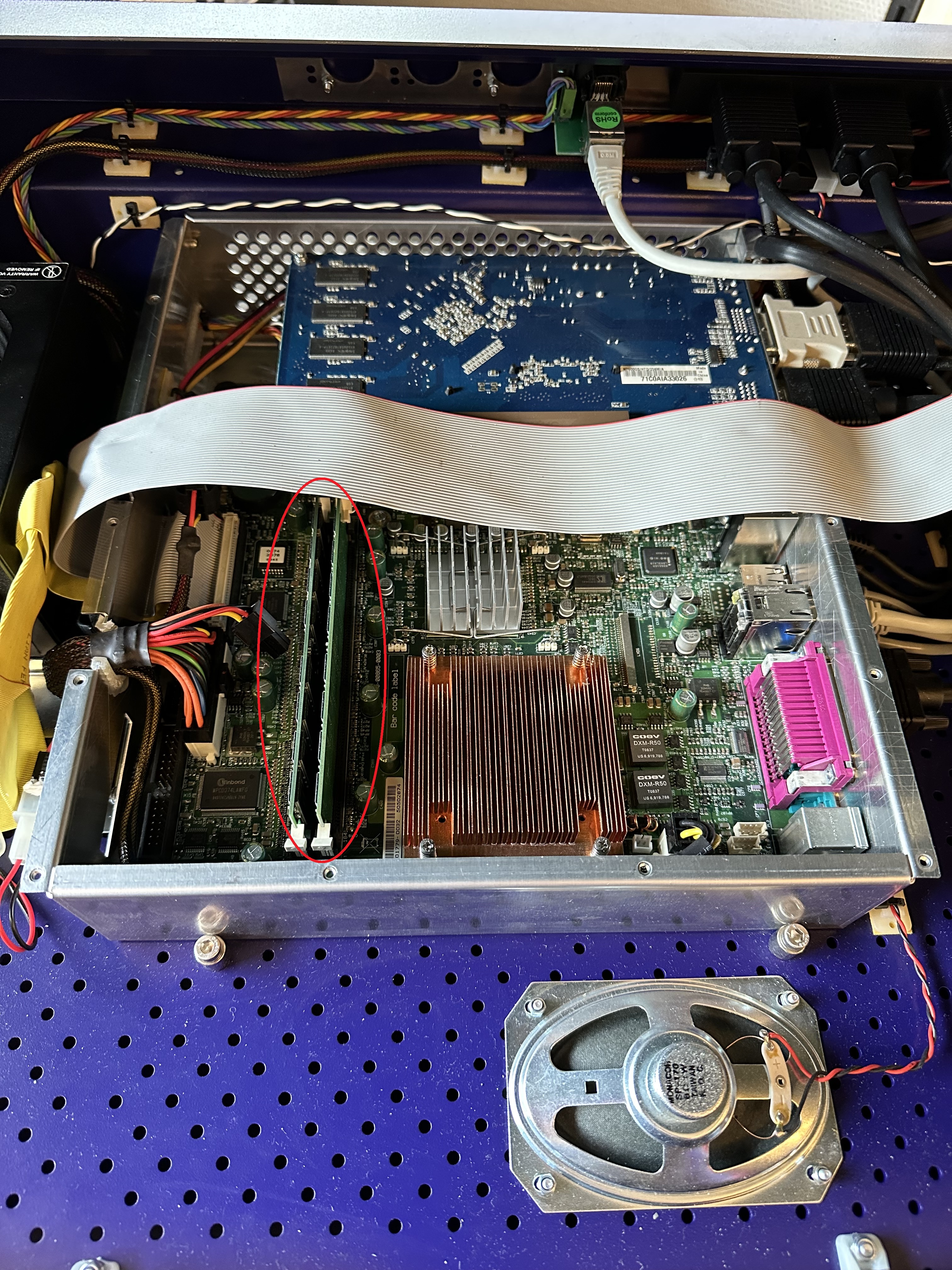

  1. With the cover off, locate the two sticks of RAM.

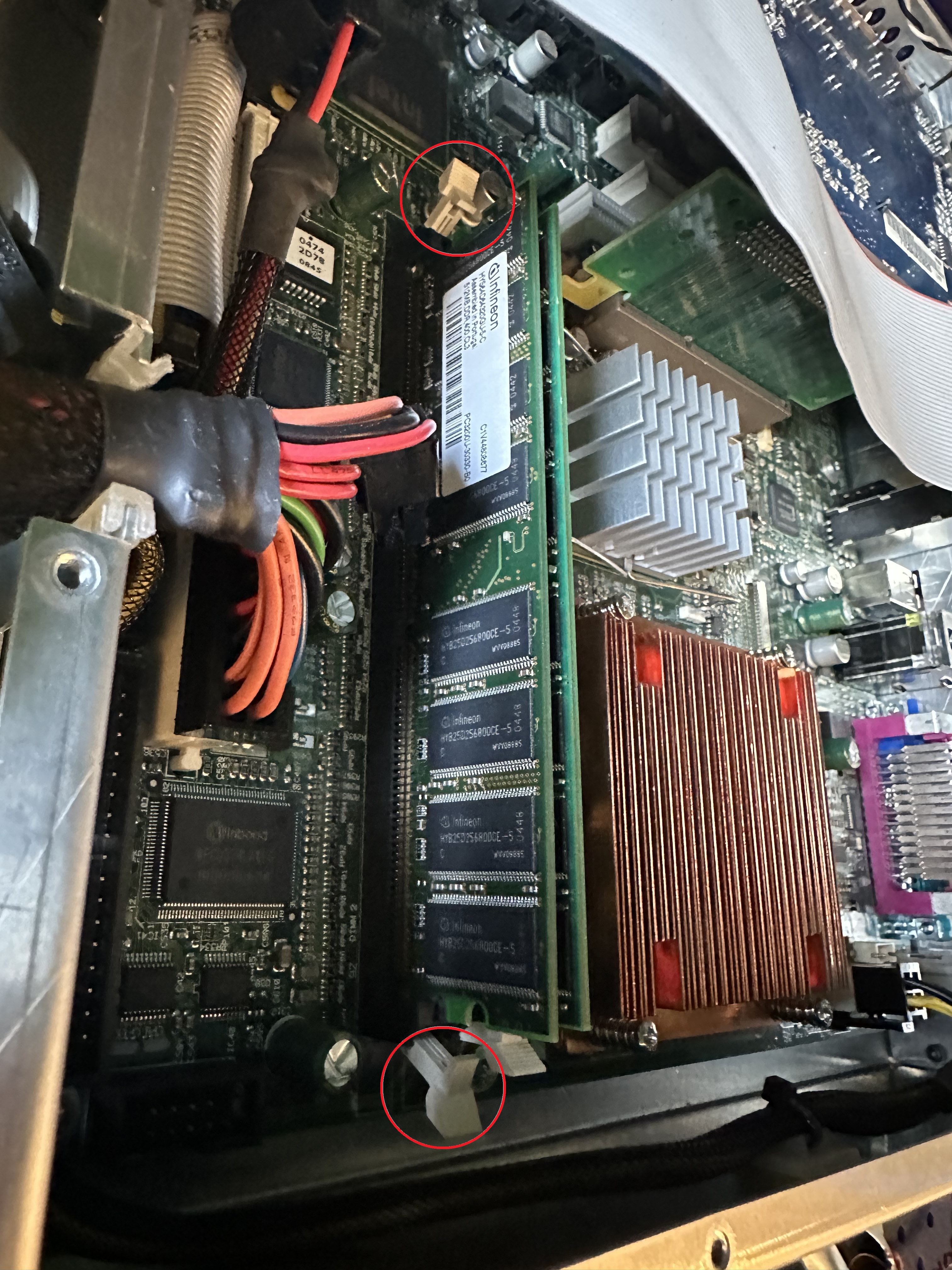

  2. Open the white tabs on both sides of the RAM as shown below.
  3. Pull RAM straight up.
