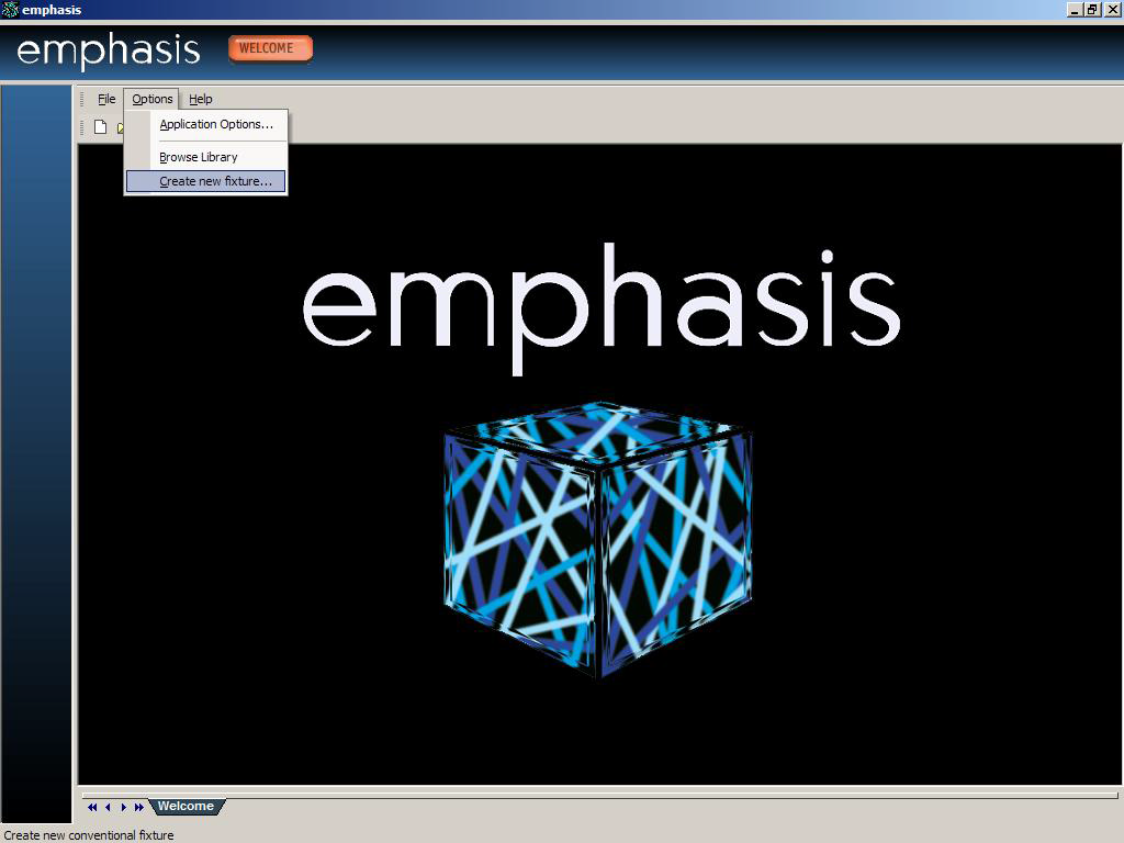

- Once the show is saved it will take you back to a blank screen with the Emphasis logo in the center of the screen. From here go to [Options], [Create new fixture...]. This option will open a popup window, where you can create a new fixture.
