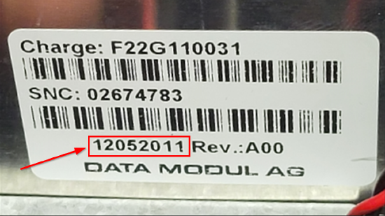

Each Display Control Board has Data Modul's Part Number on it. The easiest way to determine which ETC PN to order is to check which Data Modul PN is on the red Display Driver, however, if you find the part number of on the back of the Display Screen you can also search that number. The Display Screen PN will be the same for both monitors, determine if you need the primary or secondary as they will both use the same part number.

Part number from Display Driver Part Number from back of Display Screen
