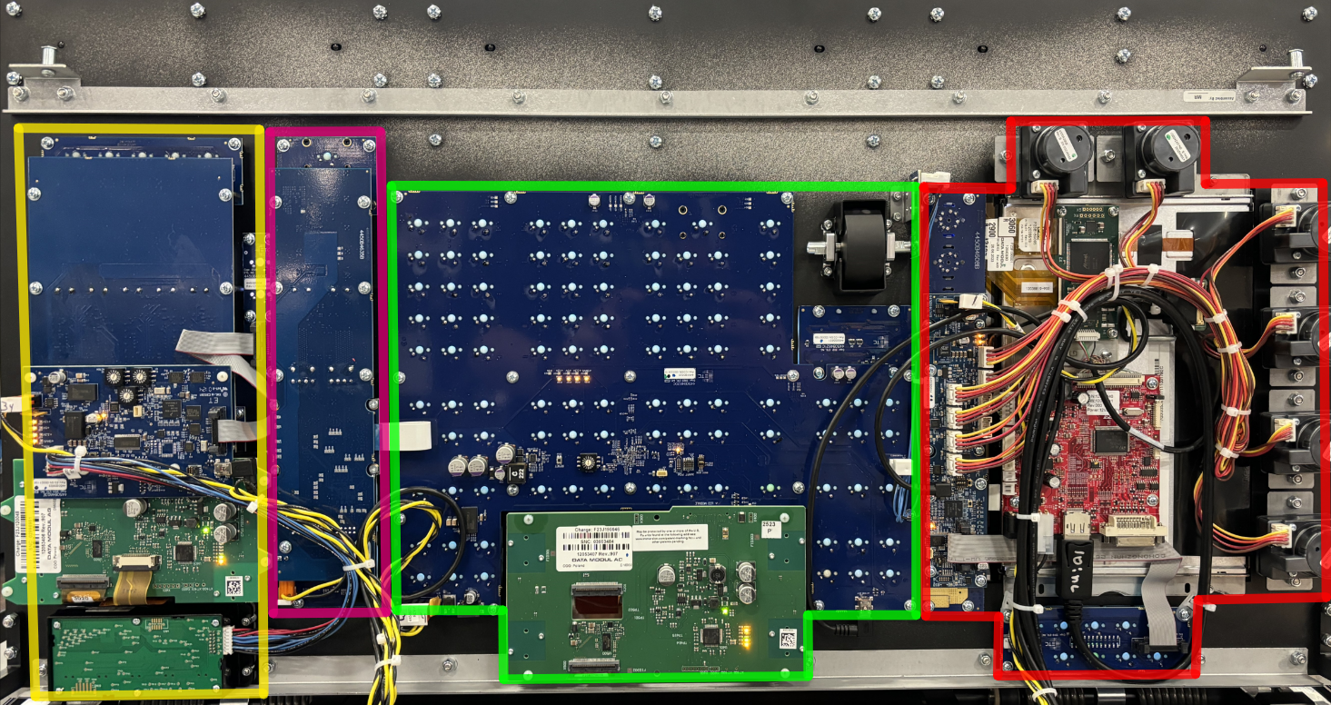

This support post will list what modules you should see in Detected Modules on your Apex 5 under Settings>Maintenance>Detected Modules. If any are missing, please contact ETC Technical Support for assistance.
Description
Apex 5 should always list the following modules but the order and verbiage may vary:
Detected Modules
If you are using fader wings or additional Gadgets for output, you may see a combination of the following as well:
Detected Modules
  •      Apex Button Module
  •      Apex Face Panel
  •      Apex Haptic Encoders
  •      Apex Main Playback
  •      Apex Motor Faders
  •      Apex Intelligent Power
