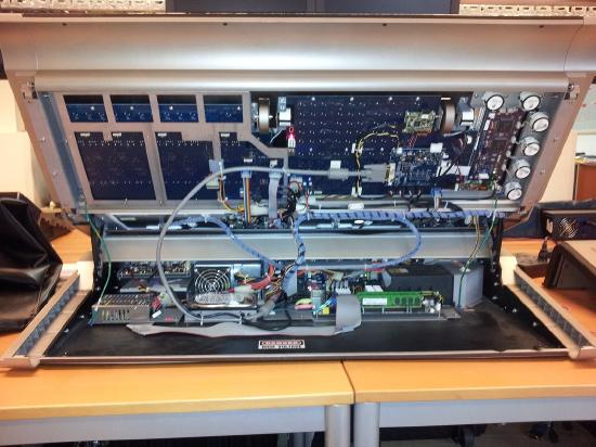

Opening
The console will now open like a car hood would.  Simply grip the front edge of the wrist rest and lift to open the desk.  When opened all the way the arms will latch into place. Make sure they are latched all the way. If not pull the arm to make sure its seated all the way.
