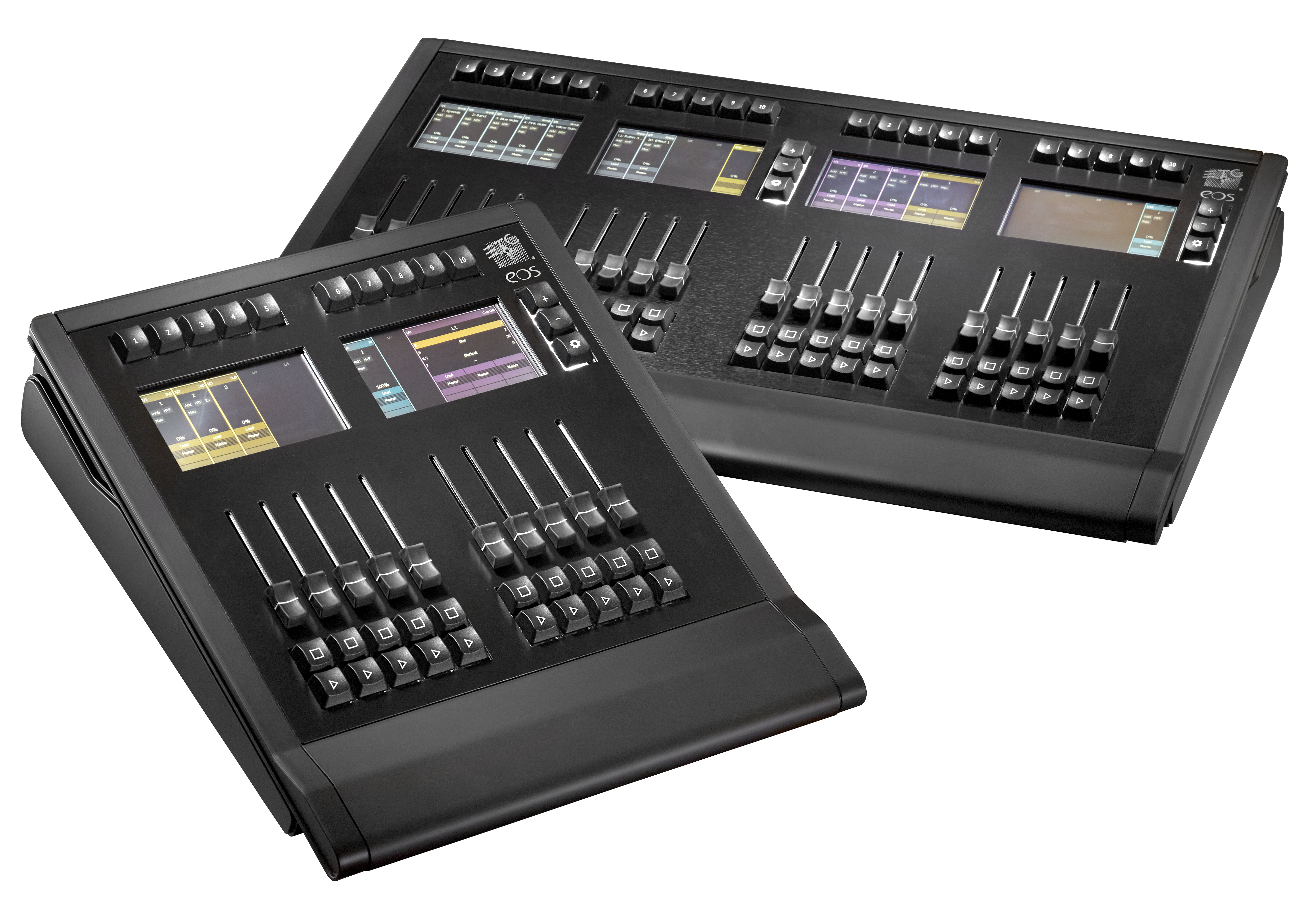

Eos Standard Fader Wing and Motorized Fader Wing Compatibility
Eos Motorized Fader Wing 3
Cobalt Motor Wing wide
  • Eos Apex 5/10/20
  • Eos Ti
  • Gio
  • Gio @5
  • Ion (Windows 7 Only)
  • Ion Xe and Ion Xe 20
  • Eos Apex Processor
  • Eos/Ion/Ion Xe Remote Processor Units (Windows 7 Only)
  • Eos Remote Interface
  • RVI/RVI3 (Windows 7 Only)
  • ETCnomad for PC/Mac (Windows 7 or higher / macOS 10.11 El Capitan or higher)
  • ETCnomad Puck
  • ETC Puck
The Eos Standard Fader Wings and Motorized Fader Wings are not compatible with Windows XP

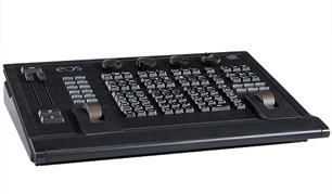

Eos Programming Wing
  • Eos/Ion Xe RPUs
  • RVI3
The Eos Programming Wing cannot be used with any consoles that have a dedicated face panel or any RPU/RVI running Windows XP
Serial # 492001361 and higher require Eos v3.1.4

Maximum Number of Fader Wings Per Console
You can have up to 3 fader wings attached to a console at a time in any combination.
  • 1 Universal Fader Wing, 1 Standard Fader Wing, and 1 Motor Fader Wing
  • 2 Standard Fader Wings, and 1 Motor Fader Wing
  • 3 Motor Fader Wings
  • etc.
The Ion Xe 20 can only support 2 external fader wings as the internal faders count as a wing.
