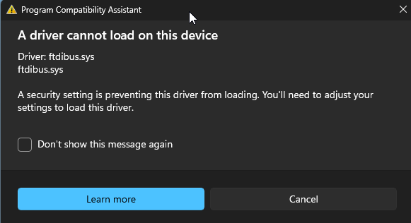

I am trying to use a Universal Fader Wing with a Windows 11 PC but it is not working.  Windows may give a Program Compatibility Assistent error "A driver cannot load on this device" referencing ftdibus.sys
Description
The Eos software is having trouble connecting with the Universal Fader Wing. The current driver does not support Windows 11's Memory Integrity feature. We are working on an updated Driver to function with Memory Integrity enabled. Please reach out to ETC Technical Services with questions.
