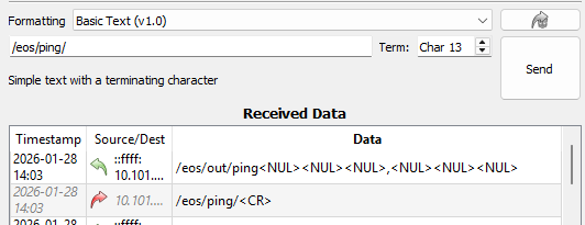

OSC via UDP: Basic Text
Depending on the receiving device, it may respond to simple ASCII messages in the OSC format.  For instance, you can send "/eos/ping/" from StringTheory to an Eos Primary and Eos will respond with "/eos/out/ping" (and several NULL padding characters) if the connection to Eos is properly configured.
