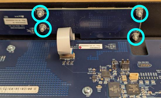

This issue may be caused by a loose ribbon cable inside the gateway. If you see this issue, you can open the gateway and attempt to reconnect this ribbon cable.
Fix
  1. On the underside of the gateway, use a Phillips #1 screwdriver to remove the 8 screws indicated below. Slide the gateway board out of the metal cover.
  2. Locate the display ribbon cable, indicated below.
  3. Reseat the end of the ribbon cable connecting to the gateway's main board.
    1. Carefully disengage the plastic latch by flipping it upwards.
    2. Remove the ribbon cable from the slot.
    3. Re-insert the ribbon cable into the slot, making sure to keep it straight, and insert it as far as possible.
    4. Re-engage the plastic latch by flipping it back down.
  4. Use an M5.5 nutdriver to remove the four indicated nuts securing the UI board to the front of the gateway shell.
  5. Reseat the other end of the ribbon cable connecting to the front of the UI board, following the same procedure as before.
  6. Re-attach the UI board to the front of the gateway shell using the four removed nuts.
  7. Slide the gateway board back into its cover and replace the eight removed screws.
If display issues persist after reseating the ribbon cable, please contact ETC Technical Services. It may be necessary to send the gateway in for service to have its screen replaced.
