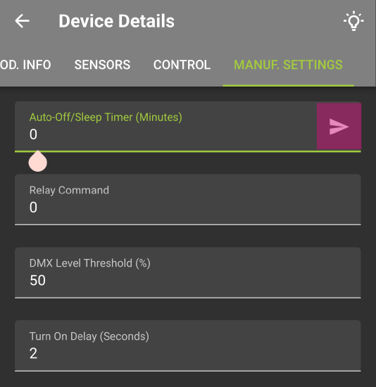

I set the Auto-Off/Sleep Timer value to 0 on my CSR-D or CSR-W using a third-party RDM controller. Now, the device does not power on or respond to control, and can no longer be accessed by my RDM controller. The only sign of life is a slow blue flash on the power LED.
For example, with a DMXcat:

Acceptable values in this field are 1-30, as shown in the ColorSource Relay Quick Guide:
0 is considered an out-of-range value.
