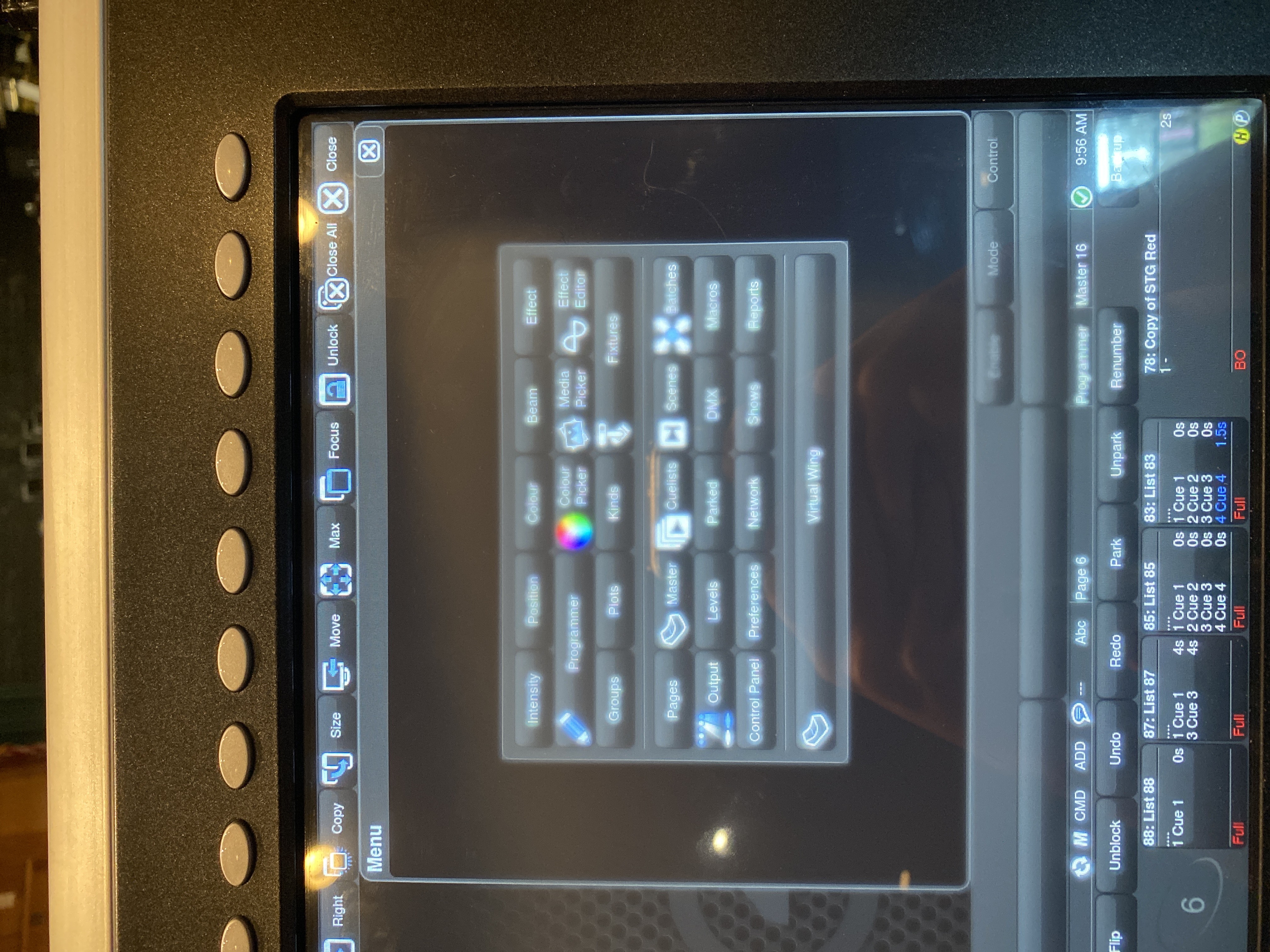

Symptoms/Issue
Display is blurry in the center but the edges are clear.
Description/Explanation of Issue Fix/Solution
  1. Console is likely being used in a harsh environment, either too hot or cold or in very high humidity. Leave console on for a while the screen should clear up by itself.
