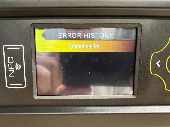

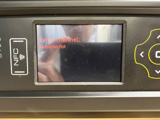

Symptoms/Issue
Animation wheel stuck in the beam or making weird noises.
You see an error "Animation Rot" after boot of the fixture or in the Main menu - Diagnostics - Error History.
Fix/Solution
Please, contact ETC Technical support.
Hint: Even if the Animation Wheel is in the wrong home position, you still can control it. Try to move it from the console to any edge position (minimum or maximum). The wheel will hit the end stop and define its position correctly. This will work until you do a power cycle.
