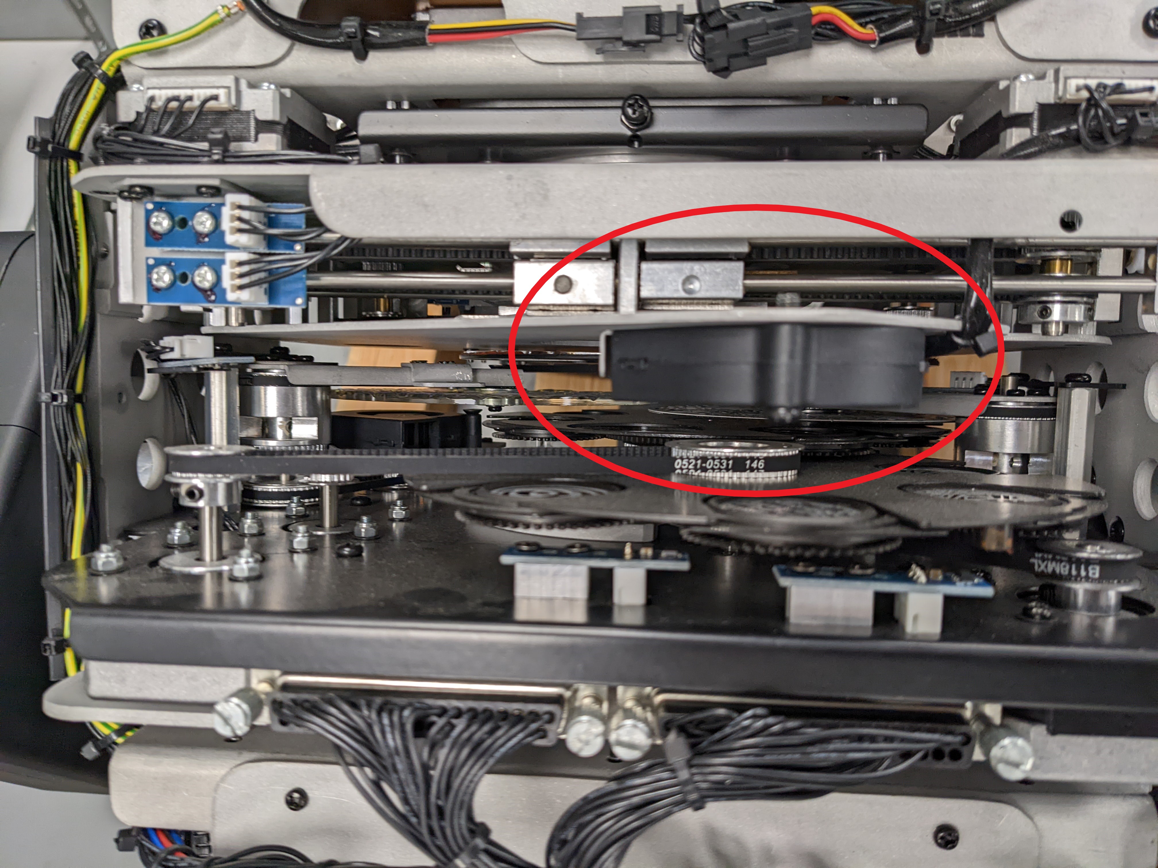

- Fixture with fan installed:

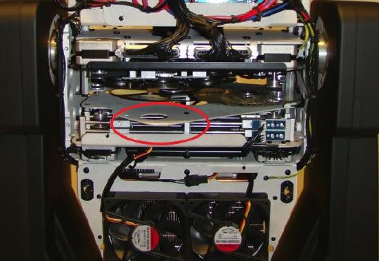

- Fixture without fan installed:
