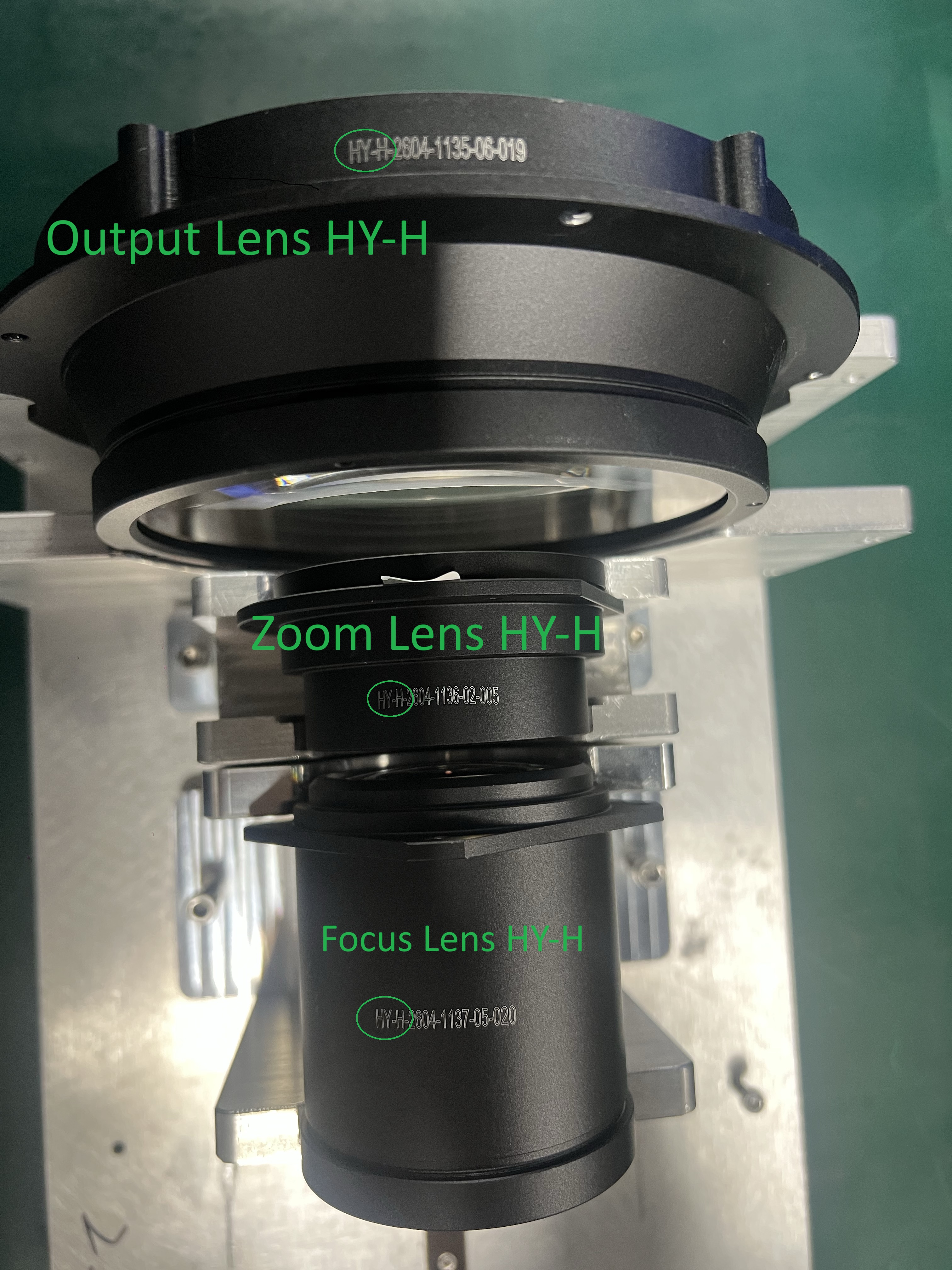

Output, Focus, and Zoom lenses marked with HY-J or HY-H must be replaced with the same lens version. See pictures below of how the HY-Y lenses can be identified.

                                              Original HY-J Lenses:
                                        Current HY-H Lenses:
