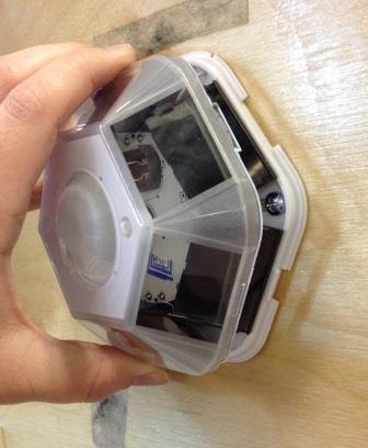

  1. Gently remove the cover of the MOS. The white plastic cover can be separated from the base of the unit.
UAOS Cover

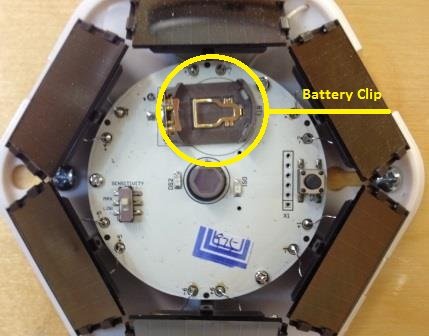

  1. The battery slot with clip will be visible on the circuit board of the MOS. Please only use a CR2032 battery with the MOS.
Battery Close UP
Note: The cover must be reinstalled for any coverage testing. The Lens for the PIR emitter in part of the cover. When reinstalling the cover, be sure to align the Teach button hole with the button.
