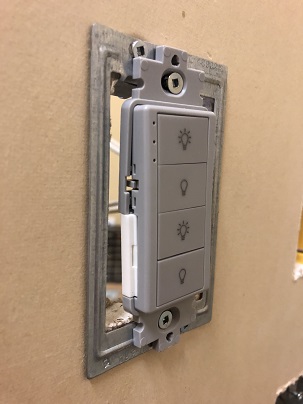

  1. Over-torquing the mounting screws when mounting over a wall junction box or mud ring. The cavity behind the wall station allows the back housing to flex ,especially if a screw gun is used to mount the MBI. It is very easy to over-torque the mounting screws when using a screw gun. This flexing causes the front housing to become unseated from the back housing, which also loosens the battery from the battery terminals (see image below).
Solution:
  1. Remove the station from the box and reseat the dislodged clips, ensuring there are no gaps between the front and back housings.
  2. Open the battery tray and reseat the battery, close tray.
  3. Install the 8188A3005 * support plate with the MBI station when remounting to the box using a handheld screwdriver. This support plate is included with all MBI stations as of June 2020
