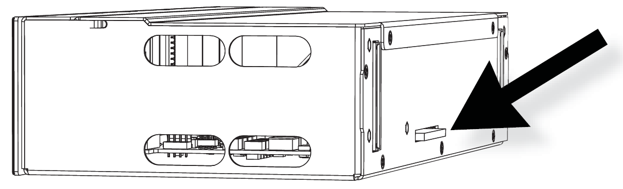

  3. Check the back of the Processor, there is a small black card, which is the CF Card.PACP CF Card Location.png
  4. Pull the CF card, check  the pins for damage and blow into the contacts to move away any dust.
  5. Reseat the CF Card into the Processor and re-insert the Processor into the rack.
