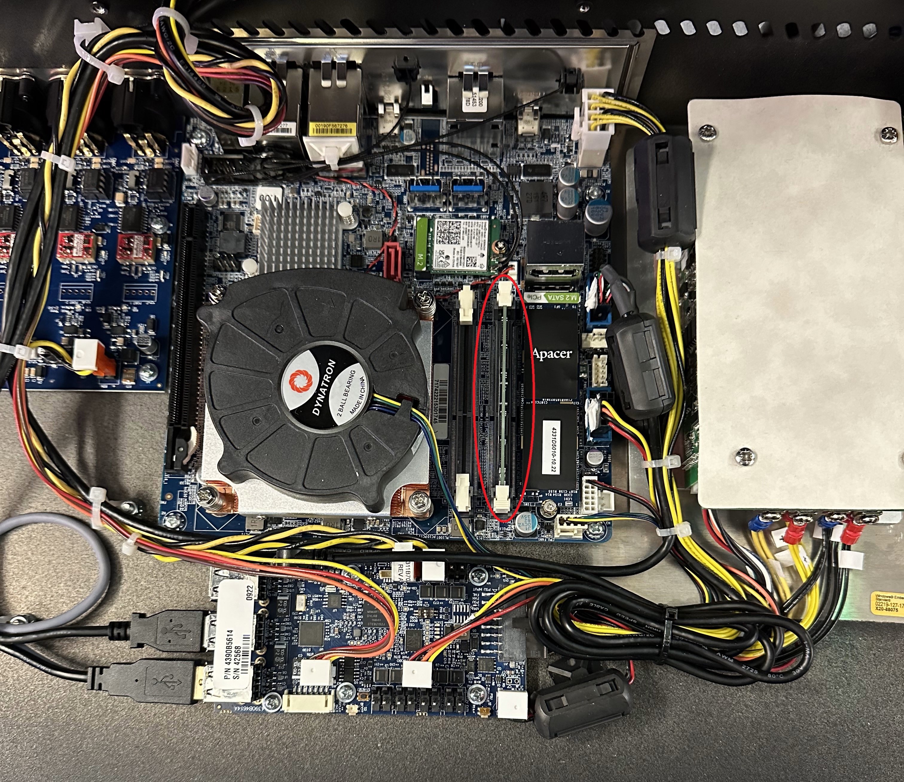

  1. With the cover off, locate the stick of RAM.
    Win 10 Motherboard

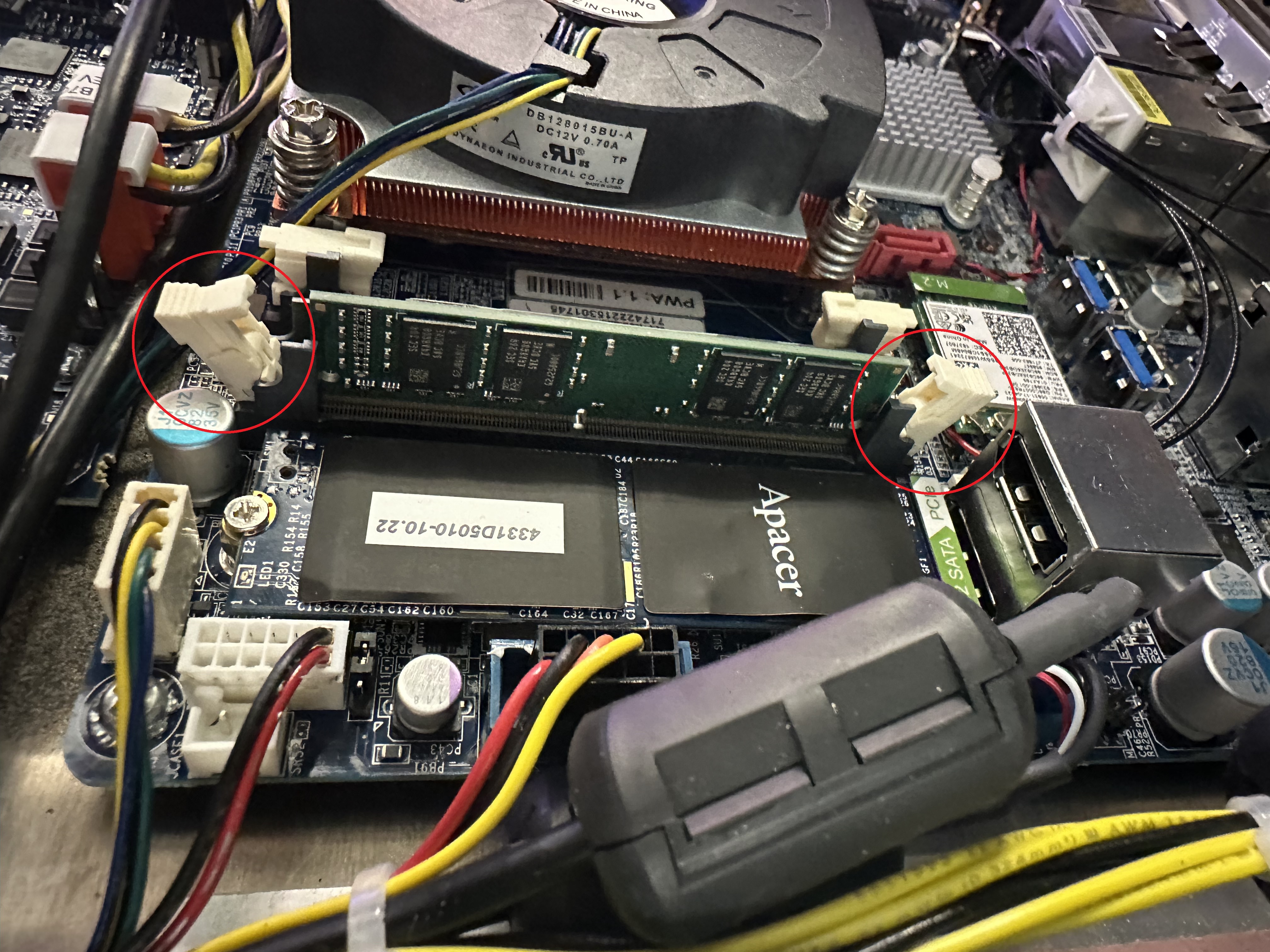

  2. Open the white tabs on both sides of the RAM as shown below.
    RAM seatedRAM opened
  3. Pull RAM straight up.
