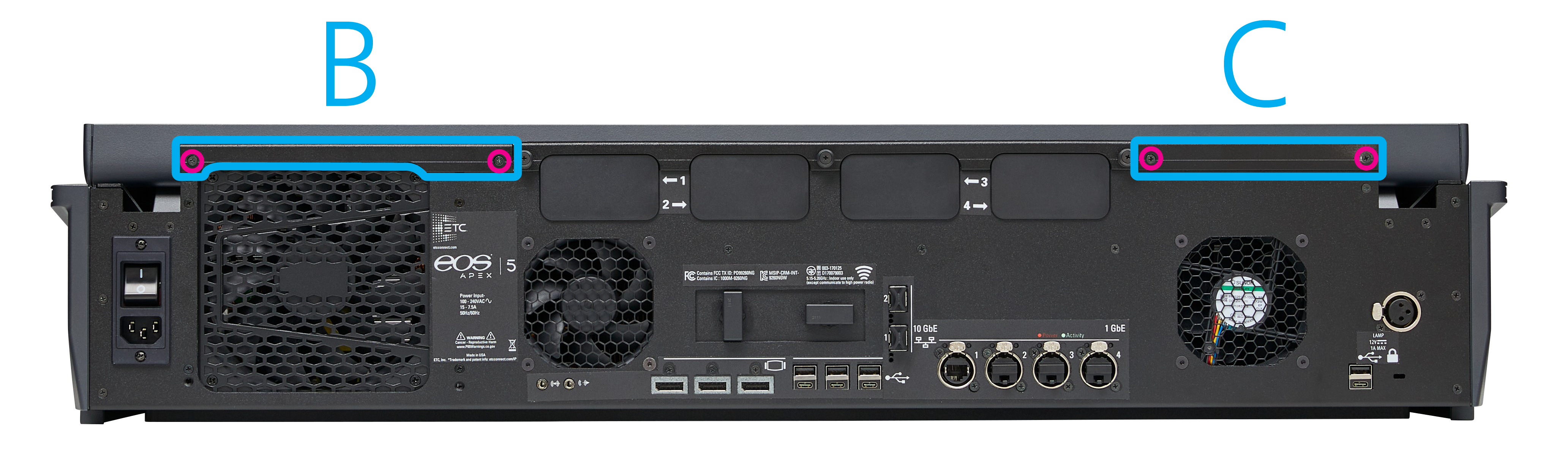

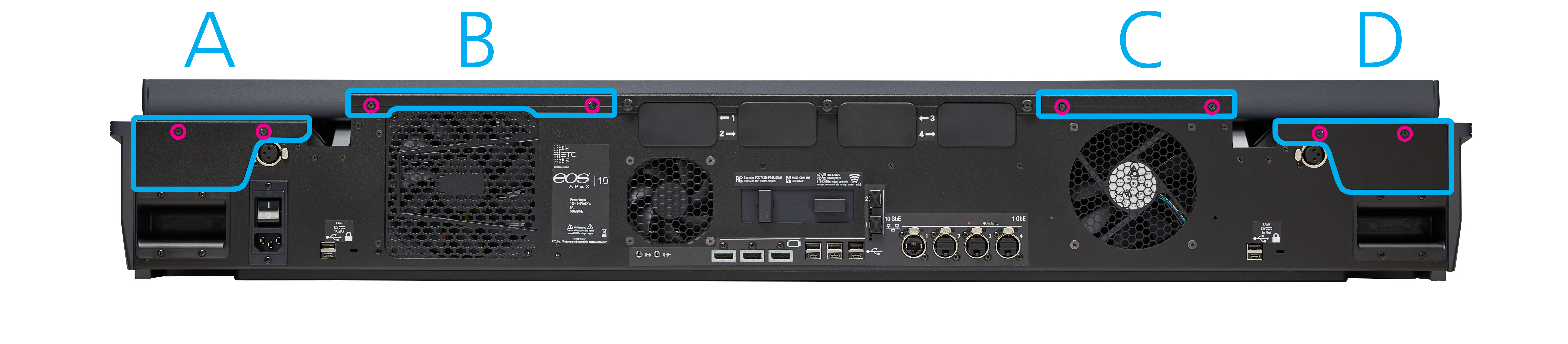

  1. Power off the console and fully disconnect power
  2. Using your Philips screwdriver, remove the screws outlined in Magenta from the cover you need to access
  3. Lift up on the cover like the hood of a car to remove the cover
Apex 5
Apex 10
