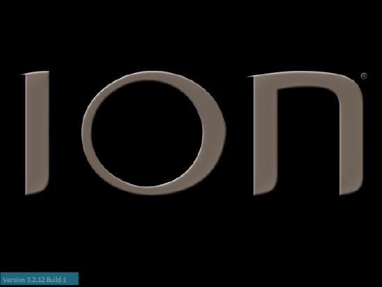

During Startup
  • If the device is currently off, power it on.
  • The software version is displayed in the bottom left corner of the splash screen that appears while the device is starting up.
