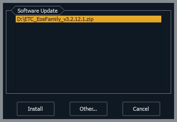

  6. Select {Software Update...} from the menu on the left side. The Software Update dialog is displayed. The device will scan any connected USB drives for valid software installers.
  7. Select the file you copied onto the drive earlier, then select {Install}.
  8. Follow the prompts during the installation process. Select {Close} when the installation is complete. The device will reboot and launch the new software.
